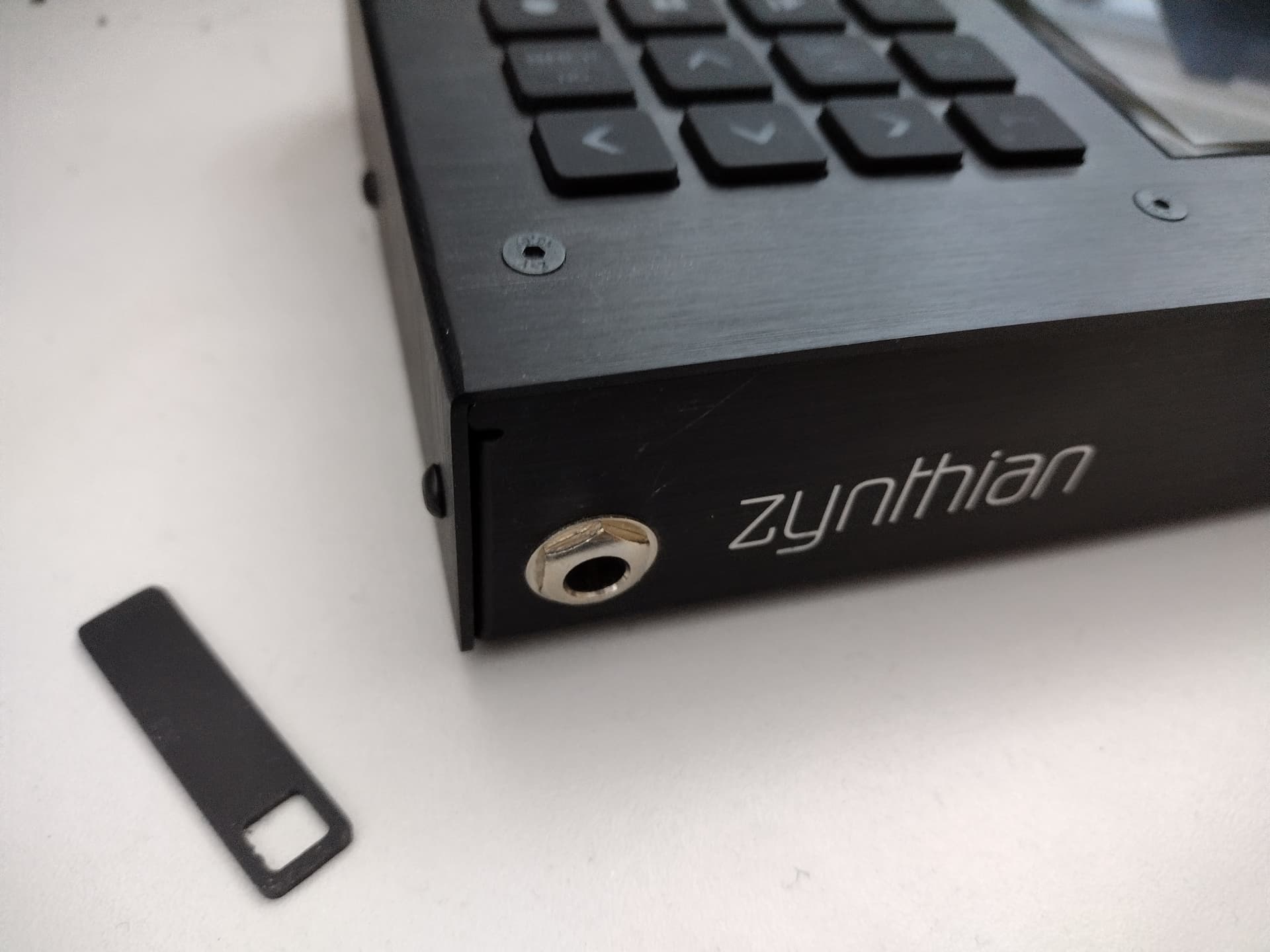

The idea disucussed above is similar to the previous versions (<=V4) where there is a hole cut in the case (preferably the top) and a socket with short tail and plug that the user attaches to the case and plugs into a PCB socket.
Indeed! You guys design and build works of art that we enjoy, but there is no harm in discussing ideas. Who know, someone here might suggest something that sparks inspiration in the lab and leads to an even more optimal compromise!
Of course … and you know that we will do our best to include some of your suggestions in next kits. I simply explain to all of you that “user wishes” are only one of the compromises we have over the desk when designing a kit. We have to make the fit with the rest of compromises :wink:

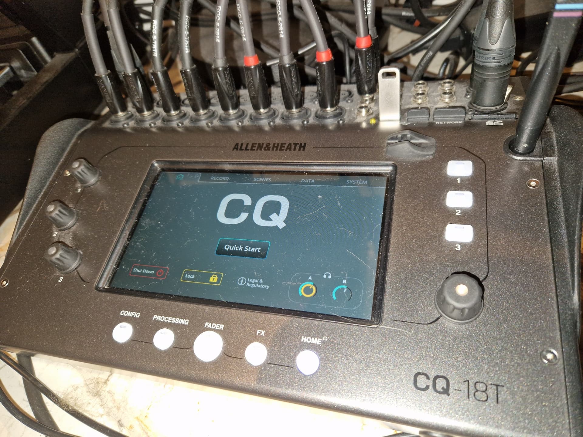

I am positive A&H CQ mixer uses an external antenna for the exact same reason; it seems to use the same enclosure material as Zynthian and they did not want to lead a long antenna inside the box.
You can see the antenna on the right hand side of the device, it can be simply folded to flat position if not using WiFi.

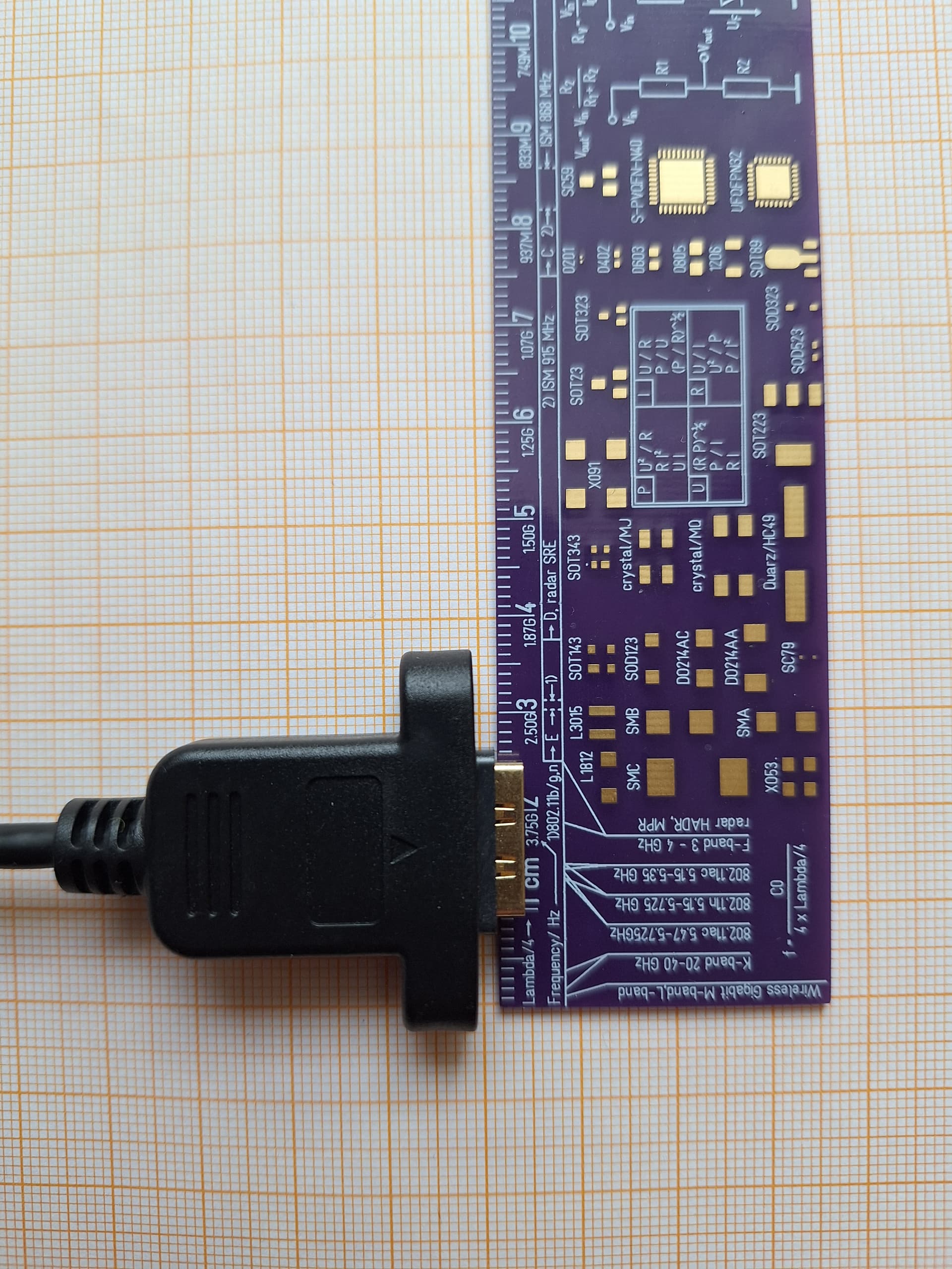

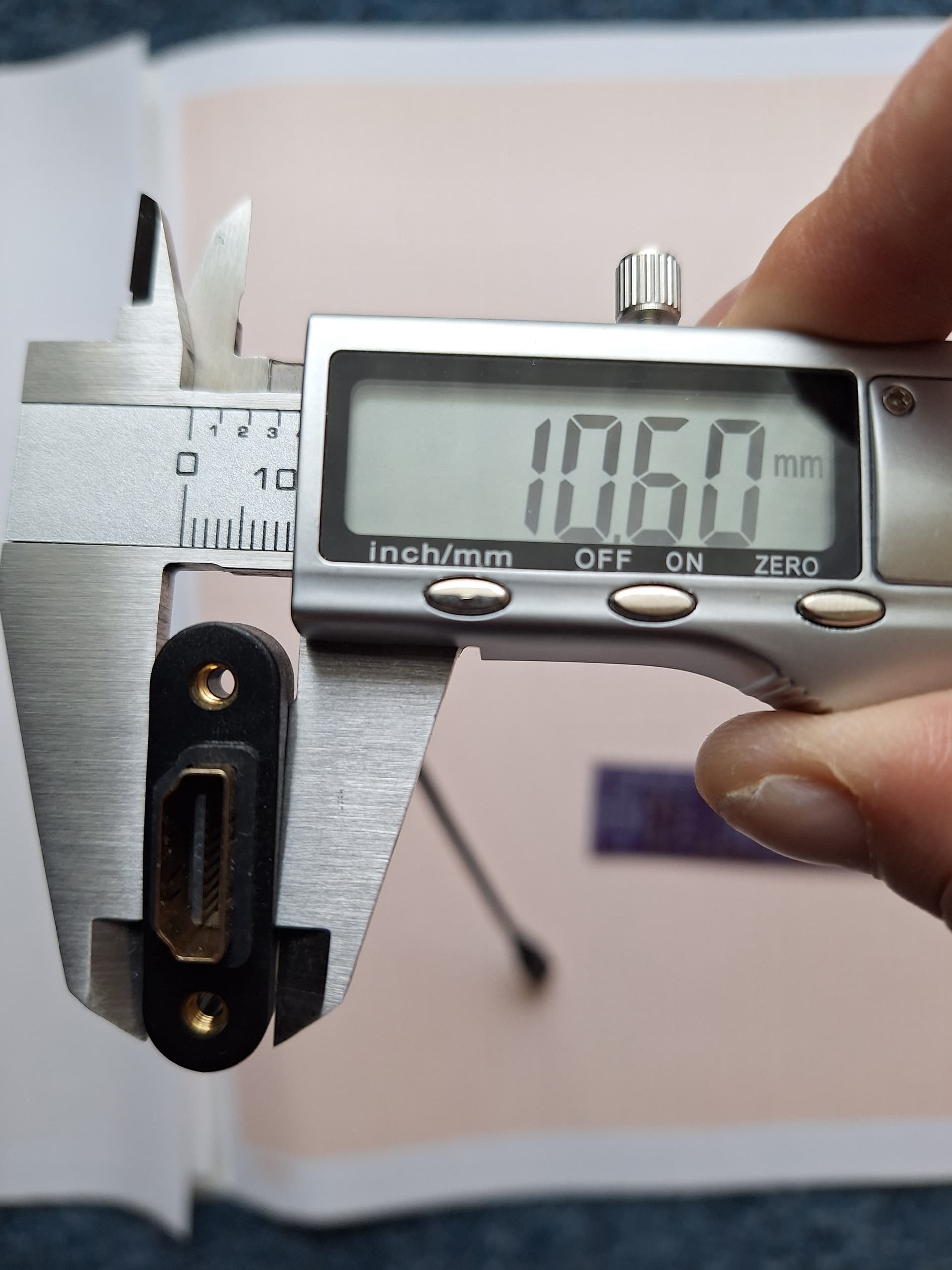

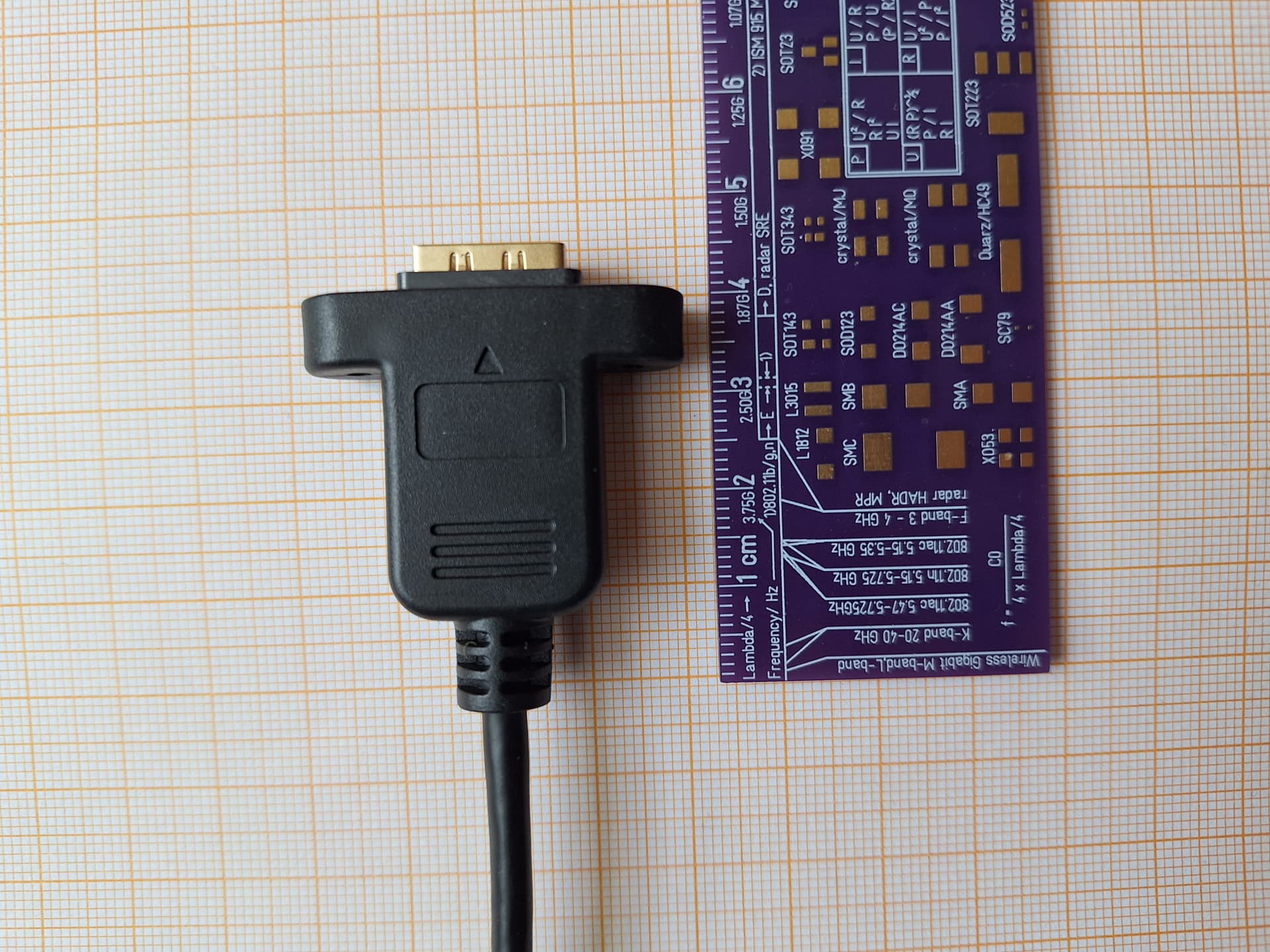

The HDMI adapters have finally arrived (ordered from here). The larger connector head front side is 37x10.6mm, screw hole distance ca. 26.5mm. The length of the head is 39.5 (44.15 with the connector).
Anything else interesting?
this is the kind of adaptator I was thinking about in my previous comment in this thread.
I didn’t found any of these with a shorter length then 30 cm, wich seems to me quiet long. But I guess there’s should be enough room inside the 5.1 case to fit it inside.
Keep us informed !
Unfortunately, I don’t have the original Zynthian V5 case, so I can’t really test that. If you need more measures, let me know.
Ah ! Ok, just like me in fact :smile:
Yes, if you can confirm the 30cm: are they just for the cable or are they the total lenght of the combo ? Thanks in advance.
Pure cable makes some 24,8cm. With the connector heads it is 31,5cm all together (+39.5mm HDMI and +27mm microHDMI).
The two metal connectors sticking out of the heads add 6mm for the male microHDMI and 4mm for the female HDMI.
