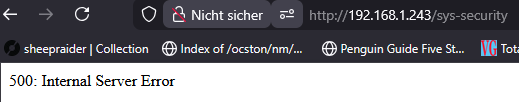

I’d like to append my problem to this thread because it seams related:
I just saw that I cannot connect via ssh with VSCode, and while evaluating the problem I also recognized I cannot connect to the webconf Security/Access page, which throws a 500 error.
The same time connecting to zynth via webconf in general works as well as Putty ssh connection and Winscp.

Still I’m kind of stuck with the webconf security/access tab (but this being the only non functional webconf page).
