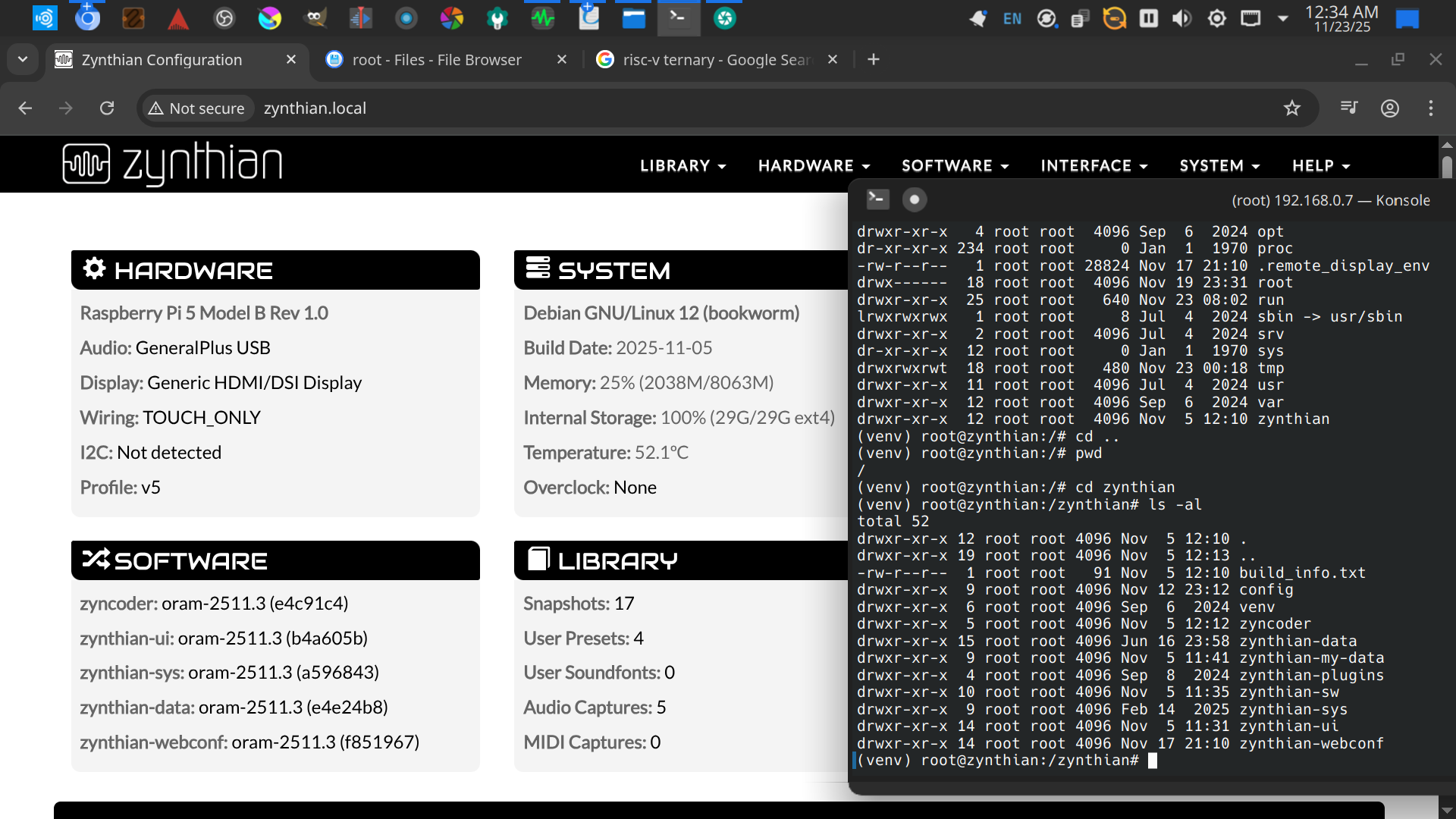

Well, if it’s any help, here’s my system, screencap of webconf with ssh to root in front of it:
It’s a fairly fresh download of Oram.
That definitely helped, thank you! :grin:
I chown’ed the directories to root and the problem disappeared. Wonder what caused it to change owner, but I guess I’ll never know :flushed_face:
