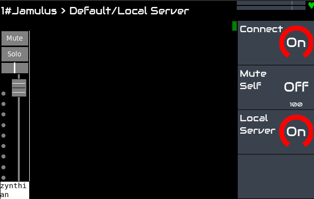

The control view for Zynthian Jamulus processor has several pages of controls and a GUI widget. The first page of controls inclues:
  • Connect - Connect to or disconnect from the currently selected Jamulus session
  • Mute Self - Mutes audio from Zynthian reaching the Jamulus session
  • Local Server - Starts and stops a Jamulus server on the Zynthian
When connected to a session, there will be a page of controls for each musician connected to the session. There will also be a channel strip for each musician shown in the GUI widget. These controls set your local monitoring mix of the session, i.e. allow you to balance how you hear each musician without affecting anyone else’s monitoring. The parameters are:
  • Fader - Adjust channel level
  • Pan - Position channel in stereo mix
  • Mute - Mute this channel
  • Solo - Mute all non-selected channels
There is also a scribble strip showing the name of the musician (as they have set in their client) and an audio level meter.
The screen reacts to touch, e.g. drag fader / pan or tap mute / solo.
The last received chat message is displayed near the top of the screen, scrolling as necessary.
There is an indication in the top right (grey/green) to show if the local server is running. (Useful if you are not on the first controller page.)

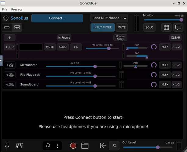

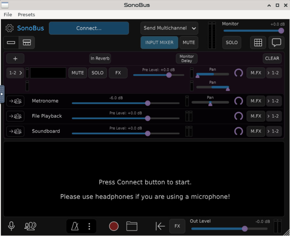

@lanmower has suggested that SonoBus be considered as an AoIP solution. Initial investigation shows:
  • Current deb package (2024-12-03) does not install LV2.
  • Building from source does create an apparently functional LV2.
  • The LV2 is built on JUCE and exposes parameters as lv2:Parameters . Zynthian does not currently support parameter control. (It is being worked on.)
  • There is a native GUI that looks functional but we would want this to work without need to refer to the native GUI.
  • We would need to perform some testing like we did for jamulus and ideally implement a graphical widget to present connection and user info. This is done for jamulus in dev branch.
