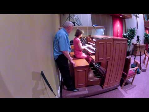

Helps to have some helping hands around…
She’s missing out on the drawbar indicator lights on this pipe organ .
(It’s a case where nice hot to the touch light bulbs would have it over LEDs)
I’ve actually spoken with her on a few occasions, a breath of fresh air and puts a smile on my face, she goes through similar tech challenges as I do and yes, you’re right about the stops to consoles like these, they’re non motorised LED centre lit momentaries and a real headache on different consoles.
