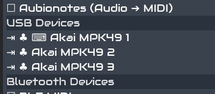

Hey just letting you know I finally plugged in the mpk49 and got it working. To some degree anyway. I had capitalised the driver ID which stopped it from loading but after fixing that, it loads up to preset #25.
I then did a find&replace on all mpk249 → mpk49 which I probably wasn’t necessary but made it make more sense to my eyes.
When I went through all the faders, knobs and buttons in the webconf midi log it appears they all seem to map the same CC# as the MPK249 except they all share a single midi channel #2 (not sure if that’s default or just my device). Because there’s only a 3x4 grid they go up sequentially in number which means that don’t match exactly after the first 3.
The main things missing on the MPK49 is the navigation buttons on the left side, 4x extra pads column and lack of a loop button. The menu navigation buttons are slightly different too.
I have only just started playing with and I have noticed the knob and fader banks don’t appear to do exactly what you wrote above, doesn’t seem to control volume or pan and the mutes don’t work with the lower buttons (in any bank setting). Some sliders were controlling certain preset parameters. The pads also just play notes instead of playing the grid launcher pattern. Transport controls appear to work. So, now that I think about it, not much is working! I’ll keep trying, kudos for the work on the driver!
