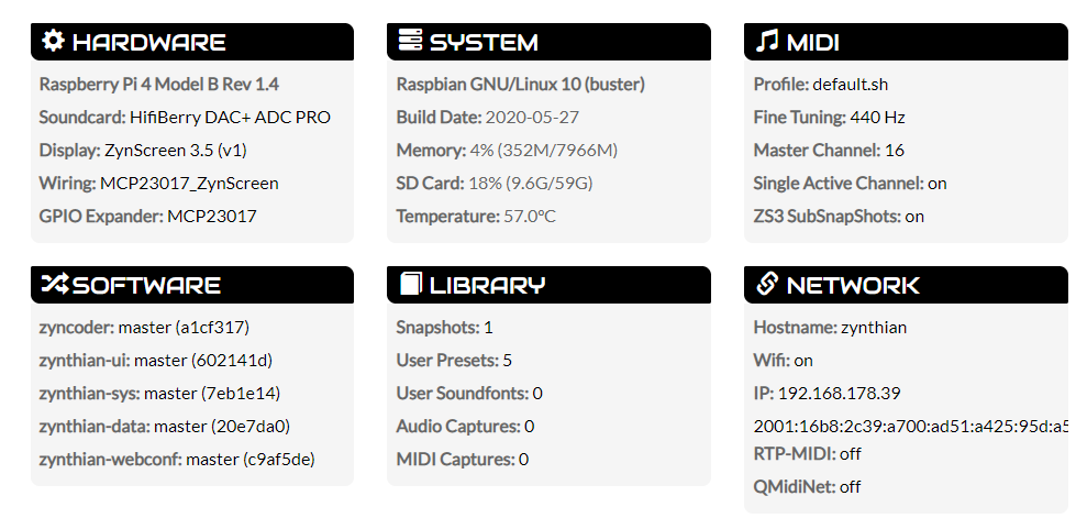

Kind of looks ok to me.
Sounds like the encoder.
Could you upload pictures of it?
See pictures above. Pasted it in an old browser tab… and I did owerwrite the post before
