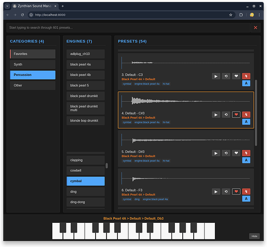

I’ve been working on something that might be useful for others (I think is “good enough to share”). It’s like a sound library that has recordings of the presets, with some basic tags. The “thing” is composed of three components:
  1. A sound scrapper, which is a script that runs inside Zynthian and automates the recording of clips of the audio that each engine/preset (or engine/preset/note in the case of percussion engines) produces, and stores them (cropped, normalized, and in OGG/Opus format) along with their meta information (in JSON: engine, bank, preset and a very basic set of tags extracted from the name).
  2. A second script that uses AI to retrieve more tags from the audio data. It uses a very old model (Yamnet), removing the non-musical labels, and some other minor adjustments.
  3. A static web app, that reads the JSON file, and presents a very basic interface to search for presets, and listen the clips, with support for browser stored favorites. This part has more room for improvement, in case of other needs. For example, I would like to add support for user tags. Here is an example screenshot:
I’m still in the phase of recording clips (Zynthian has a huge collection of engines/presets!), and my plan is to upload the app to Github pages, so anyone interested can browse it.
Nevertheless, I think that we can get more of its potential if it “runs” inside Zynthian (of course, enabling it only if needed). It would not incur in any overhead (its an static app, only the disk space), and could be easily updated with local presets, filtering disabled engines, etc. Moreover, once the user finds a suitable sound, there could be a button that communicates with Zynthian and automatically adds a new chain with the engine/preset, or updates an existing one, etc.
Well, this is what I have until now. If there is some interest, we can move on. Otherwise, it has been a very fun project! :smiley:

There is some interest. I think this would be great!
I find it awesome as it might help to solve another problem: looking for presets using the tags and classifications.
It looks very promising :slight_smile:
