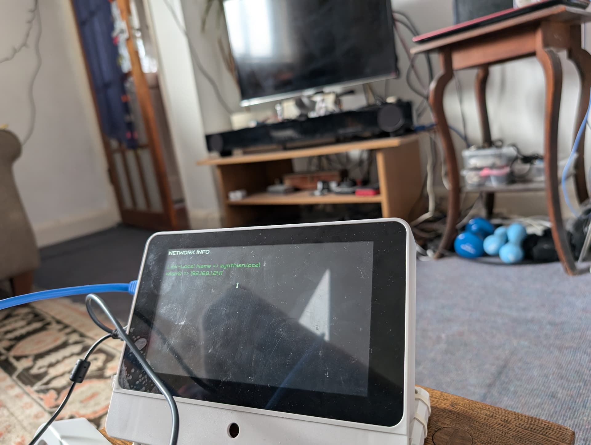

Edit: 22 hours (and many probably unnecessary system rebuilds) later - it looks like I should have simply set my browser to the .local domain listed under ‘Network Info’ all along.

Loss of wired network is very unusual. How are you testing this? Are you using an IP address or hostname to connect? What does the network info show from admin menu?

Can you see any indication on start up of an Internet address? can you ping on the network and does the Pi show up in the Router list? There is always the possibility of IPv6 connection which complicate behaviour like this.

I did a reboot of my laptop to see if that helped. Interestingly Zynthian reverted to a completely powered-down state when I did this. The ethernet cable was plugged in. Also, I have now got (what I assume is - because I have no idea why else I would have a wired usb C to mains adaptor) the official power supply plugged in. Sadly there was still now ethernet when I unplugged it and plugged it in again to let it power up.
