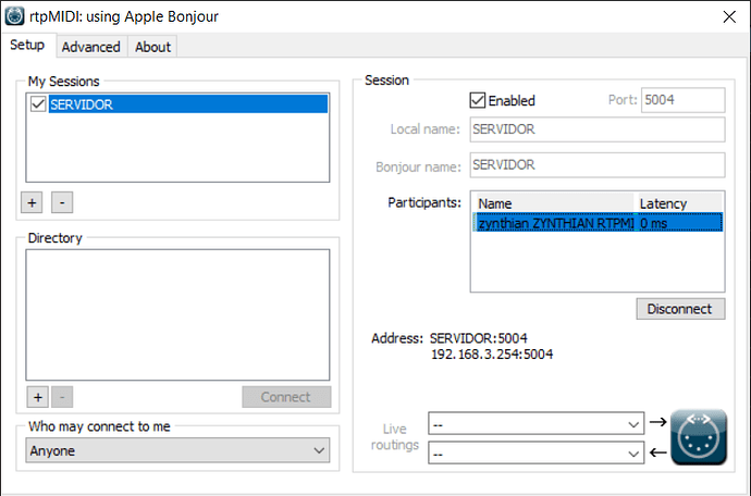

Hello everyone, friends, I would like to know if there is already an updated method to send the SYEX from created with the version of VST DEXED VST for Windows to Zynthian?
Can syex be sent via direct file? , or you have to send it by command.
I am connected via midi via the MIDI RTP protocol: windows > zynthian.
If I try to send the SYEX via WEBUI, it shows this error, in the last photo.
