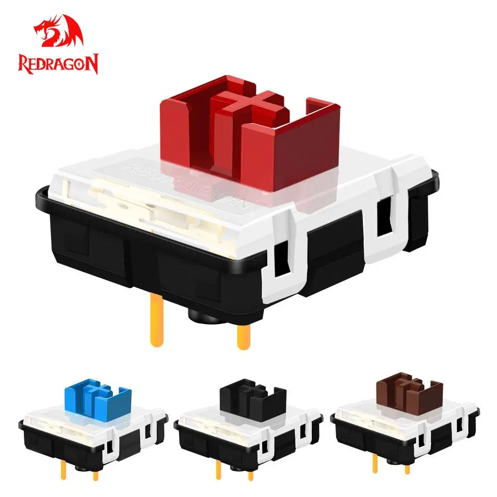

it’s fully OSHW.
ANd also, on Ali, these unknown mechanical switches that are really affordable (extremly low cost is the word)
