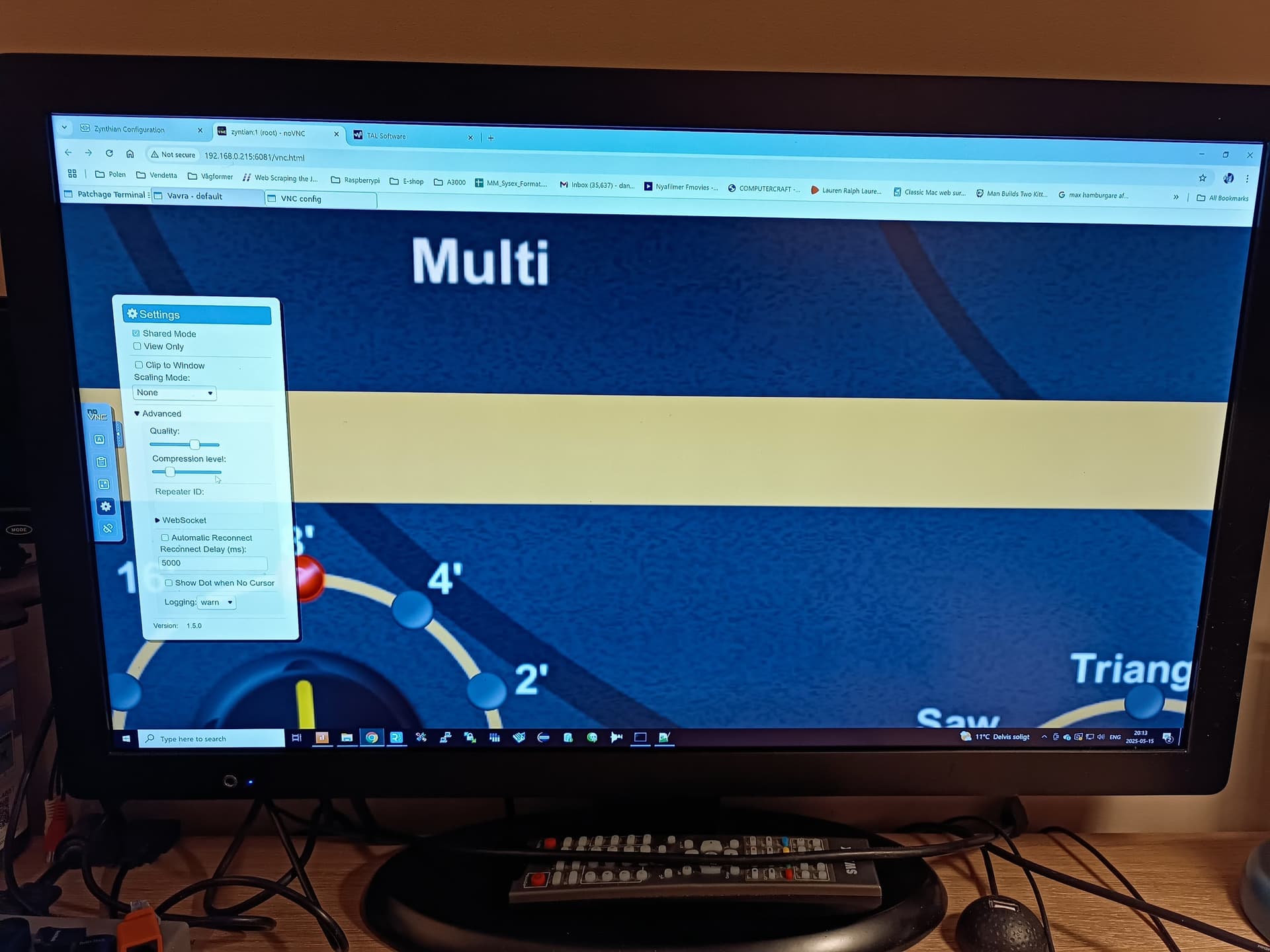

Vavra is more hungry. I also stumbled across this issue where i changed the GUI scale, i could never return back to the default (whatever i try, i get this super-zoom effect showing huge controllers in the UI). Are there any tricks to effectively reset the UI in VNC?

As for resetting the view magnification of Vavra on VNC, please try (if you already haven’t) the configuration buttons hovering on the left side of the display: there should be general zoom setting.

I tried to alter the left-hand popup menu & tried to change the GUI scale of the plug itself but nothing really helps. I always get this super-zoomed UI no matter what i do. What would be the trick to essentially reset it?

Hi @ledan
Did you try to set scaling to local or external?

Hi maartmaart,
yes i tried all of those options (in fact, every possible combination of option in that menu) but the screen stays super-zoomed regardless of what i do unfortunately.

Hi @ledan, considering that no initiative of sort has been undertaken to make Nodal Red compatible with Raspberry, my guess is that there must be some kind of implicit GUI scaling incompatibility, with Raspian-based systems.
My suggestion is to reinstall the plugin from scratch, in order to override any possible saved GUI setting.

Hi there @Aethermind, ah no, the culprit this time is Vavra (who keeps obstruating with its scaled up UI). But i will try your advice and actually remove it and install it again to see if it can go back to its normal “self” again :slight_smile: I wouldn’t quite dare to get my hopes up on the Nodal Red yet (until the rPI6 enters the scene). It was just this experiment to see if at all it could load and somewhat function (and it can, to some degree).
