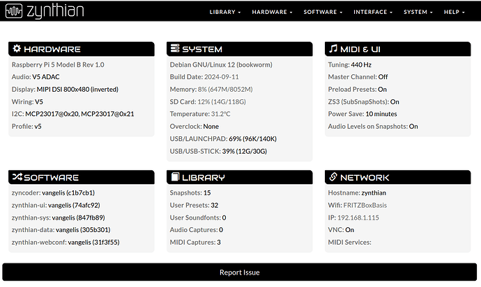

Is this a raspi 5 or 4?

FYI we had to change that too. But I remounted it as 4GB tmpfs (we have the 8G Pi 5 version)
