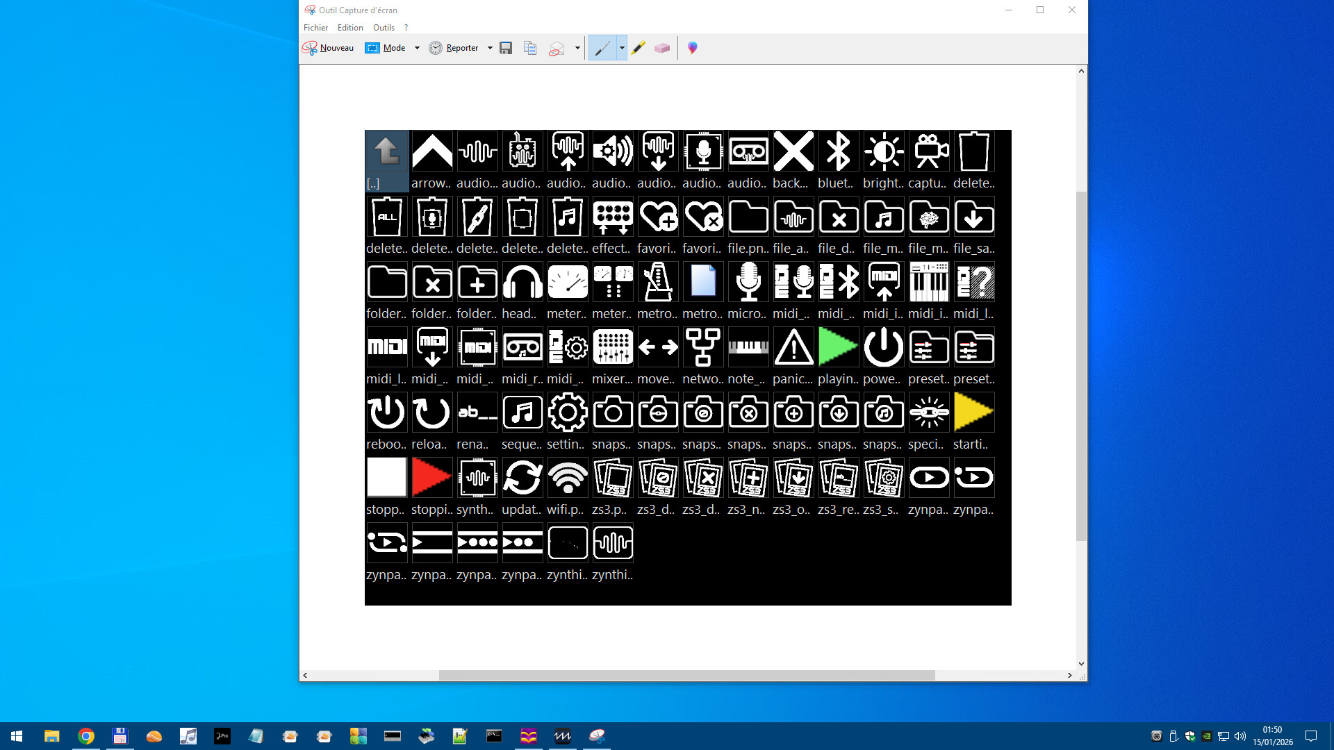

The reason I wanted to use a StreamDeck to control Zynthian is
SD has 32 buttons so it would have been nice to have all the fine png in zynthian-ui/icons
on buttons
