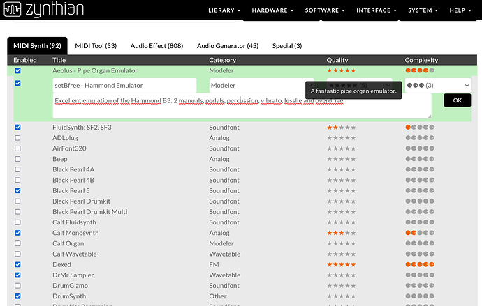

Good idea @riban. I went ahead and grabbed some screenshots from the UI and updated the page to display a gallery of UI images.
After I started, I realised it would be cool to use the gallery as the basis for the entire page. You can link the images direct to the page (whether internal docs or a link direct to the synth/effect creator’s docs directly). The gallery shows a description on mouse hover. I like the idea that someone who is exploring the wiki can click the synth engines link and see a wall of UI images, that should get people more curious and remind them of all the stuff sitting under the hood.
After looking at this more, I decided to update the list of synths on the wiki page into a sortable table. I copied the full list from webconf then added more headings to provide an almost complete list of descriptions and categories for the synths with a space for notes and guides. It’s possible to click the headers (e.g. sub-category or author/project headers) and sort the list the way you want to help discover what’s available. Suggestions on column headings are welcome.
I referred to threads such as below and many websites on a process of Zynthian synth discovery to make descriptions and categories for everything. I hope it is helpful for people. It was quite a bit of work, and I wondered whether people don’t use half of them? Maybe now they will? Along the way I found interesting things such as the physical modellers, PC soundcard chip emulators (MiniOPL3, reMID), OS-251 digital Juno style synth and the drum synths that @ToFF has been putting lots of work into.
One thing I would ask @riban or @jofemodo is if it’s possible to install a table editor extension for the wiki? This table is pretty big and it’s a pain to make changes if others want to edit it going forward (such as adding more guides).
I have another table saved on my computer for the effects list. These are probably more self-explanatory than the synths with their sometimes obscure names. I think adding the sub-category and author/project can help to see what effects are less common (e.g. granular). This list is a monster though and I won’t be filling it all out. There are sites such as below which I used to create the table (import from spreadsheet) but something built into the wiki editor would be best to make updates easier.

engines are categorized in the UI and you have to browse across the different categories to find the engine you want. The separation between LV2 plugins and the rest of engines doesn’t exist anymore. Engines are engines.
when browsing engines in the UI, some extra info is shown. Currently this info is only available for users using the “4-rotaries-at-right” layout (V5), but we are looking for the best way of making it available for “classic layout” users:
All this engine info is stored in a json file at:
/zynthian/config/engine_config.json
The description is not limited in length, although only the first 100 chars. (aprox.) are shown in the UI because of the limited space.
So, we have a comfortable, fast, coherent and decentralized way of editing engine info.

This taxonomy problem can be a bit thorny. When adding the descriptions I was thinking: what is a useful way to describe each synth? I went with a sub-category to add things like wavetable or FM to the main synth category or author/project because maybe you found an author’s plugin interesting so you want to try more. But yes, KISS is best.
Could tags be one solution? I was wishing for tags while I was combining these descriptions, sometimes devices combine multiple qualities that aren’t just ‘virtual analog’ or whatever. It can become crowd-sourced categorisation. Not sure if that would be useful inside the zynth UI though (maybe it could with touch capability?). Or is this just adding unwanted complexity? I don’t know.
Regarding the descriptions, I noticed the ones that provide a description of the types of sounds it can achieve were helpful. I mostly picked them up from github or the project pages but the quality varies. Here some better examples of technical and/or functional descriptions:
Very descriptive but what kind of sounds does it make or what is it good for? If you are more experienced you may see this list and understand what types of sounds it can achieve
A bit more ‘what can it do’ and how to use it. When I read this description I want to try it!
This one is a bit technical description but also gives a sense of what sounds it can make e.g. ‘Juno’, "lof-fi’, again I want to try it
