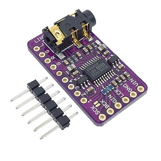

Quality can be measured if you define your parameters but is mostly objective. (See the works of Robert M. Pirsig for a philosophical investigation into quality.) If I play in a rock band, almost any I2S interface (and most USB interfaces) would provide sufficient quality. If I were making a high definition recording, I would be looking for large dynamic range, low noise floor and low level of distortion in which case I would be looking at the DAC, analogue circuitry and probably most importantly the power supply circuitry. So the range of I2S soundcards would range from:
this $3 board
to a Hifiberry card which is regarded at the higher end of the “quality” range. If zynthian’s official soundcard fits your build then I would recommend this because we love zynthian.
