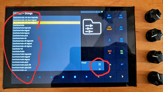

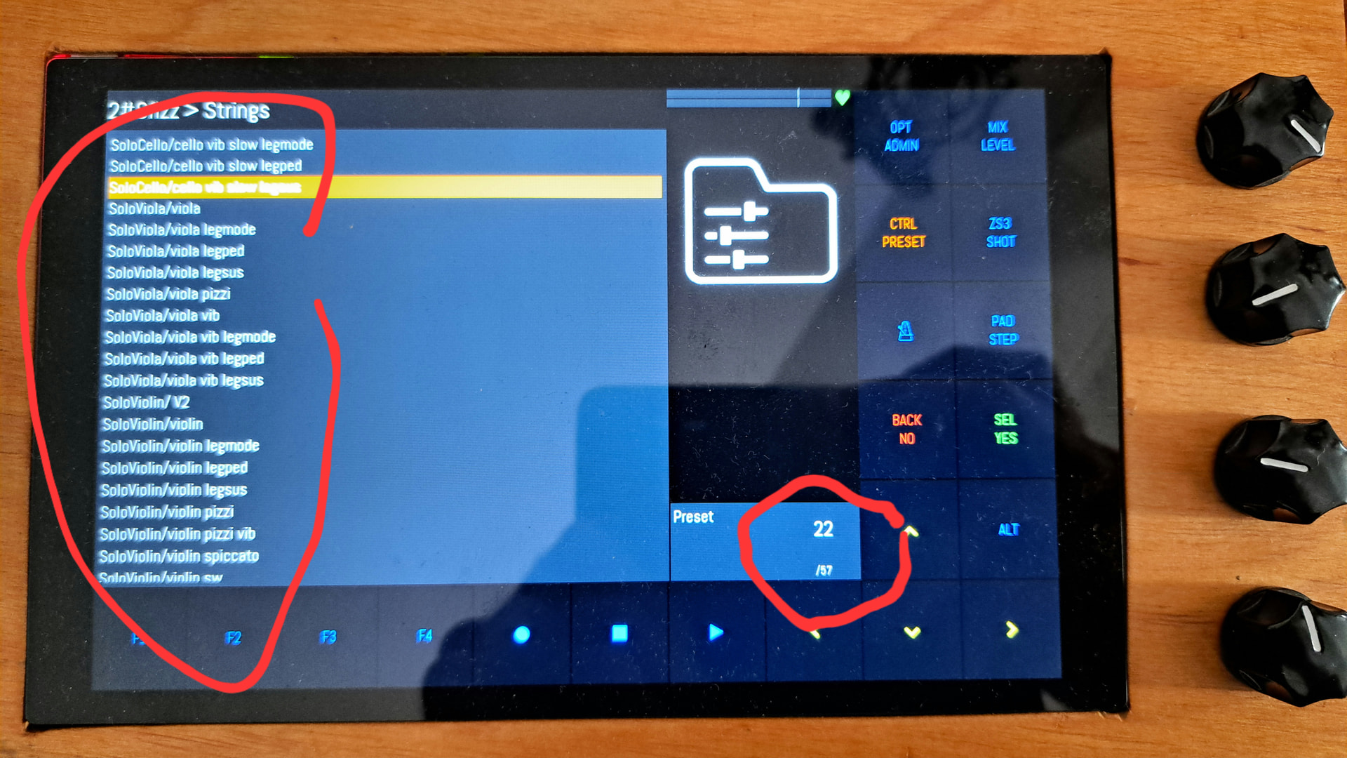

Ok, seems you are serious about keeping multiple sfz per instruments, which is fine. So we need to think together with @jofemodo about changes in the way sfz patches are presented in the UI.
My proposal: we need different menu levels of “instruments” and “versions of one instrument”.
I would really want just one entry per instrument, but then there would be some variants one level below, but indicating some kind of main/recommended patch.
Because I don’t want to scroll through hundreds of "Trumpet_A_Flutter_modwheelcrossfades_stereo_EWI.sfz"or similar, before I find my tuba.
I mean, look a this and tell me you don’t know what I mean ![]()

I think most of the SFZ files we currently see under a single “instrument” folder can actually be merged into one SFZ. Let me explain with a concrete example and why it matters.
The SoloViola folder contains these files:
R1.sfzS1.sfzS2.sfzS3.sfzS4.sfzS5.sfzS6.sfzV1.sfzV2.sfzV3.sfzV4.sfzV5.sfzV6.sfzviola.sfzviola_legmode.sfzviola_legped.sfzviola_legsus.sfzviola_pizzi.sfzviola_vib.sfzviola_vib_legmode.sfzviola_vib_legped.sfzviola_vib_legsus.sfz
The files with a single letter + number (like S1, V3, etc.) are building blocks that are included by the more complex patches (legato, legato sustain, etc.). Interestingly, Zynthian’s UI does not offer these simple building blocks as selectable patches, but it does offer the higher-level patches.
If we switch to selecting articulations/variants via keyswitches or CC, the selection can still be presented nicely in Zynthian via the existing YAML definitions. In that model we could have one main SFZ for keyboard that contains all variants internally. This also makes it easy to:
- store the selection in ZS3 snapshots, and/or
- map it to a CC number chosen by the user, and/or
- use dedicated keyswitch notes.
Then, for something like SoloViola, I could also create an EWI-specific version. So instead of many visible patches, the folder would expose just:
viola.sfzviola_ewi.sfz
It’s not just the display, the ability to select ordering is of great value.
If well handled it’s a great aid to locating things especially in an environment that ( at the moment) lacks a search facility.
Exactly.
Zynthian UI doesn’t offer these building blocks or mappings since it only showed sfz scripts on the first subfolder level. Otherwise it wouldn’t be able to distinguish.
