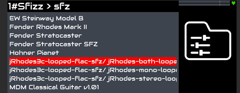

Generally, yes! We must consider that the upper folder structure also appear as “presets”, so we have to deal with another layer of the same preset structure, which would be categories (electric pianos, first level folder) → instruments (jRhodes, second level folder) → variants (i.e. jRhodes Mono, multiple sfz-files in second level folder). Another idea could be that the variant selection also appears as an addional auto generated rotary encoder or any other user input method inside a patch. Perhaps we could a short list view for stepped named parameters like these, so instead a rotary encoder presenting the currently selected value as a name it could present a tiny scrollable list inside the controllers UI real estate or as a short pop-up frame? I’d anyway still prefer to reduce its number as far as it appears meaningful. I would really appreciate a clear patch list were you find your desired instrument quickly.

Hey, slowly! I don’t detect any insult here, please take into account that in a forum with a majority of non native speakers speaking english subtle distinctions of politeness in greating formulas might not be familiar to everyone.
The example @HansR gives is in fact the current form of presenting sfz for sample sets having more than one script per folder. I we add another layer, this would be fine.
