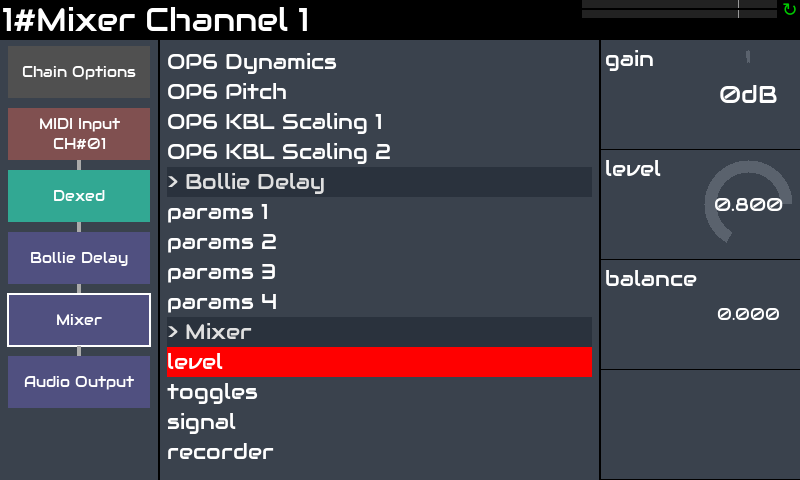

The mixer controls are now accessible as a normal processor in the chain. Easier and more coherent than before, but quite different:

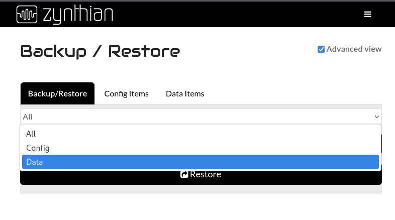

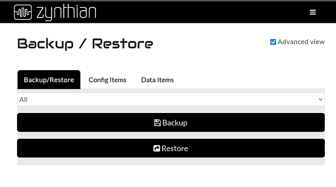

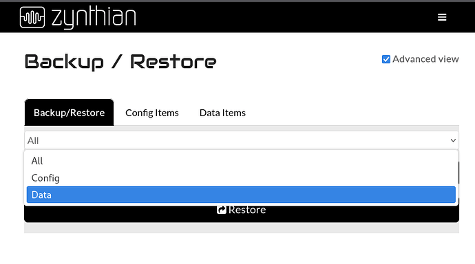

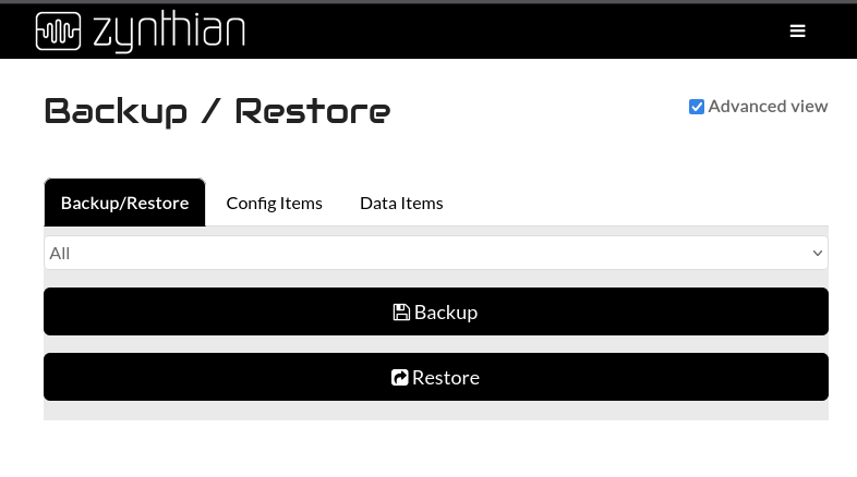

And how do you transfer only data?
You select “data” int the selector from the backup/restore tool:
