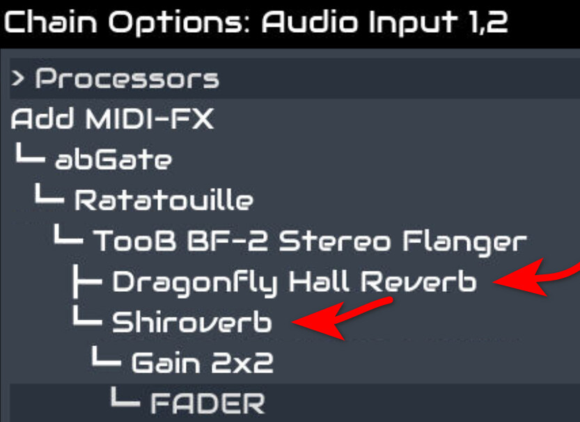

Dear @experts
How do I add effects to parallel chains? So in the picture at the red arrows, how do I add a serial chain of plugins after the Dragonfly reverb and add a serial chain after the shiroverb?
Thanks in advance,
Maarten
I’d add another chain and route the output of that chain through that. Like an fx bus.
Same. But i think i read somewhere that someone (Riban i guess) contemplated to do what you want, MaartMaart in one chain, and even having a more graphic mod-ui like approach to it
Thanks @Baggypants
I will try it… but it seems a provional solution… But if it works… it works…
I think I need 4 chains for this…
1 for first serial plugins that is fed into 2 serial chains that is fed into 1 serial chain…
or?
Cheers,
Maarten
Thanks @core.east
I did not know this involved also parallel chains that have more than 1 plugin in each of the parallel chains…
Cheers,
Maarten
Chains are built from slots. Each slot may contain several processors which will all be in parallel. Slots are in series with their predecessor. So you can have serial then parallel then series, etc. You can’t split a chain to have multiple series paths. This has been suggested but is not supported by the chain manager architecture. Such a workflow requires using separate chains.

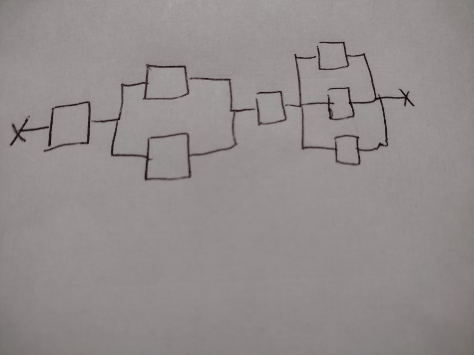

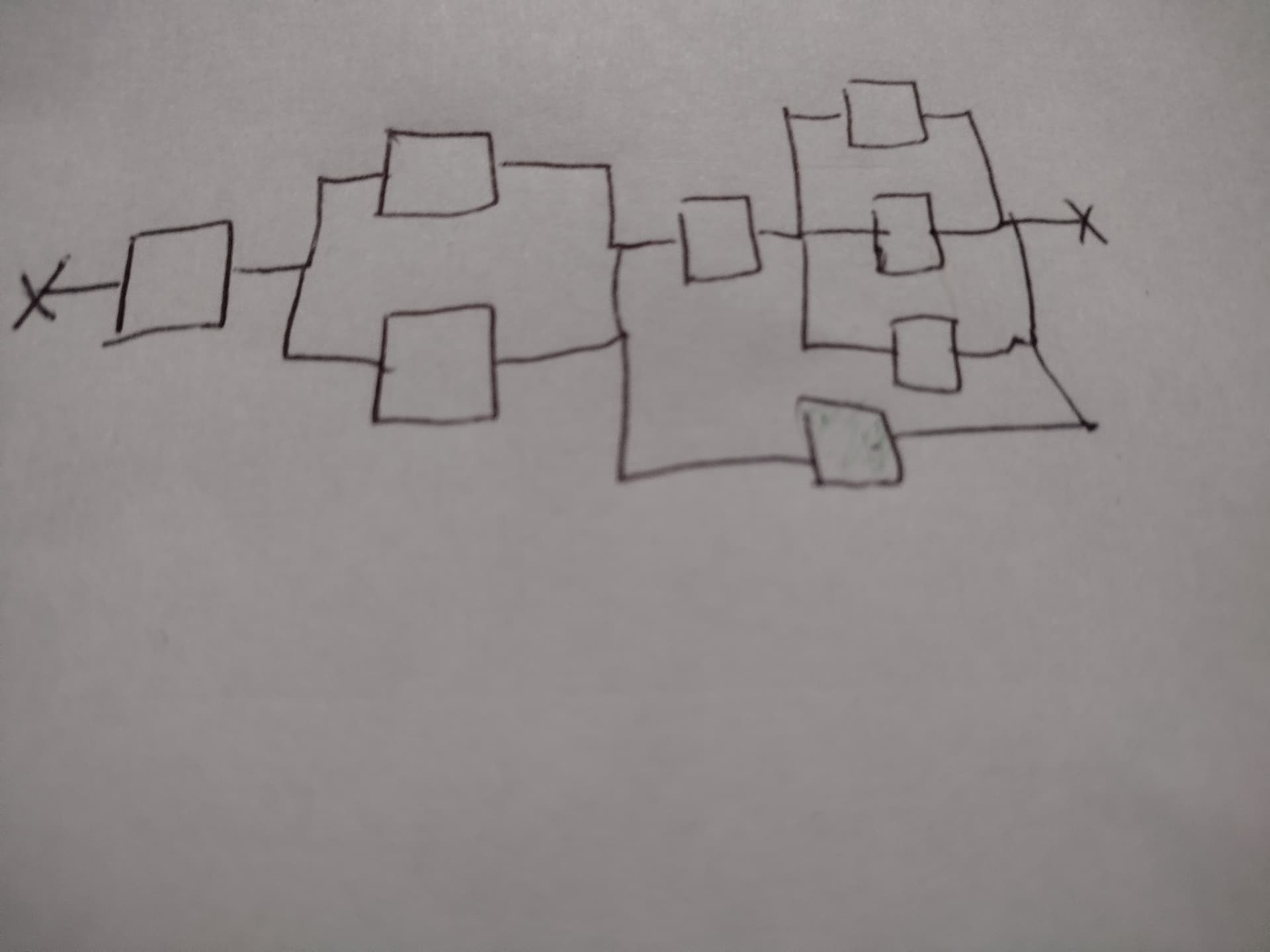

This is possible:
This is not:
There are no plans to change this. If there is a substantial benefit then a feature request may be considered. I remember you made a good point but I forget what it was!
Thankd @riban !
Nice that you took the time and effort to make a drawing for clarifying the issue.
