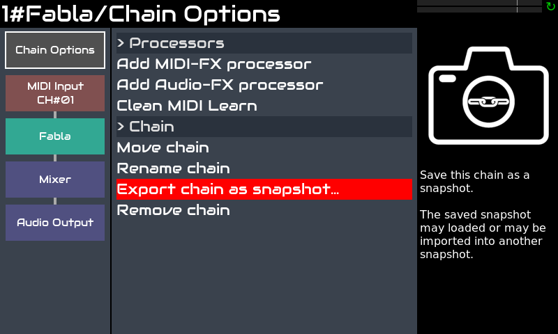

No need for this! You can save a single chain as snapshot:
It also works in Oram.

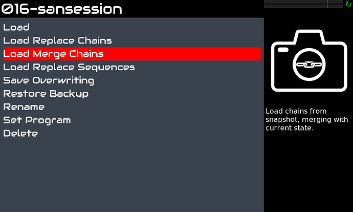

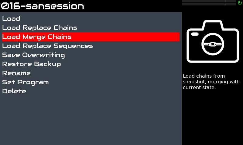

And you can use the load-merge snapshot option to load the chains from a snapshot (also single-chain snapshots) on top of the current chains:
And this is also available in Oram. Both options are old ones.
Thanks for the reminder of the export as snapshot feature!

Yes, of course Merge load and replace ChainS works.
But neither of them is the function I was looking for. It either replaces ALL chainS or just adds the chain to the existing project. → Resulting in Two Chains playing the same incoming Midi. This is not exacly what you want hapening in front of an audience. And Yes, the default Answer to that was: You don’t need to change Instruments chains live. Because thats not how we think you should make music. Ok.
As I explained a month ago, none of the loading options work for replacing a single chain.
