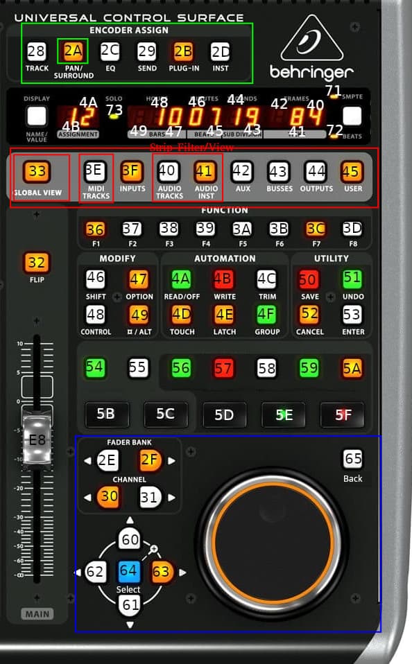

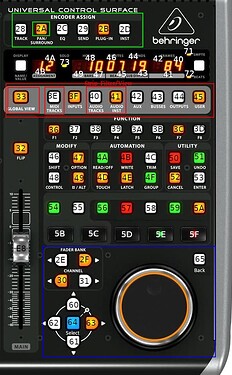

Latest Update, (I’ve not stopped, I’m just extremely slow) everytime I add a feature I break something else (usually several), which I suppose has a positive effect of me improving the code structure. Life beyond Zynthian is also busy
Using the Strip View (red box) we can view less chains e.g. midi chains only, audio chains only and instrument chains only, the buttons are predefined and it makes sense to reuse them. “GLOBAL VIEW” show all chains. In all cases the chain order is kept to how the user has ordered them (e.d. moved chains are respected). In the case of the chain type “MIDI + Audio Chain” they are viewed in both midi and audio views.
The Blue Box - The arrow keys, select, back and scroll work correctly, but the Faderbank and Channel buttons need to be optimized (not enough time today to fix them)
The Green Box - Encoder assign, only the PAN button has a function so far.
My CALL FOR HELP for the 7 buttons 54 to 5A I would like to use for zynthian “OPT/ADMIN”, “MIX/LEVEL”, “CTRL/PRESET”, etc Short and Long Press Buttons. I’ve looked everywhere and I fail to see how I can integrate the multi use for these buttons.
No sweat. Is it the spiraling , slowly, outwards amongst several related projects?
Use CUIA ZYNSWITCH with a single parameter indicating which switch. It will implement the short, bold and long press functionality.
I thought there might be a simple answer
And what is the parameter for the e.g.OPT/ADMIN button, or where are they listed?

@maartmaart Thanks for the tip, reading through all of Pavel’s posts I now understand how to use the Custom Switches shown in the WebUI Wiring to get it to work.
Adjust the Switches Pins instead of default dummy for 4 switches “-1,-1,-1,-1” n = 0 to 3. To then with “-1,-1,-1,-1,-1,-1,-1,-1,-1,-1,-1,-1,-1,-1,-1,-1,-1,-1,-1” for n=4 to 11 (Mackie Buttons 54 to 5A and WebUI Custom 1 to 7) and n=12 to 20 (Mackie Buttons 36 to 3D and WebUI Custom 8 to 15). I will deplay commiting the changes until I’ve added checks that enough buttons are activated, perhaps also add an info in the logs.
