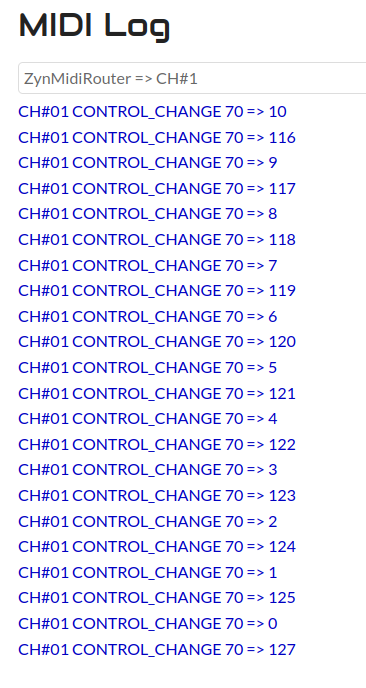

Could you show the clean output from your MIDI controller?

Anyway, the MIDI-CC learning is not processed in the ZynMidiRouter, but later, so what you are viewing in the MIDI log can’t be affected by the selection of absolute reverse, relative, etc. Indeed, you shouldn’t see CC going out the zynmidirouter the CC number is checked. By default only pedals are.

Now it looks like the controller input signal is fine, but the Control Feedback signal appears on MIDI channel 1, which, whatever it is, is the exact opposite of the controller input values. So after every 127 there is a 0, after 126 there is a 1, and so on, as shown in the picture. This is the case even when the fader is set as usual, and even when I reverse its operation. The effect is predictable: crackling, chaos.
When I set the same fader to a normal parameter, there is no problem with it, only with the SetBFree drawbar parameters.
Zynthian and SetBFree are set as they are after a fresh installation, so the problem is not with my device, but with the factory settings.
