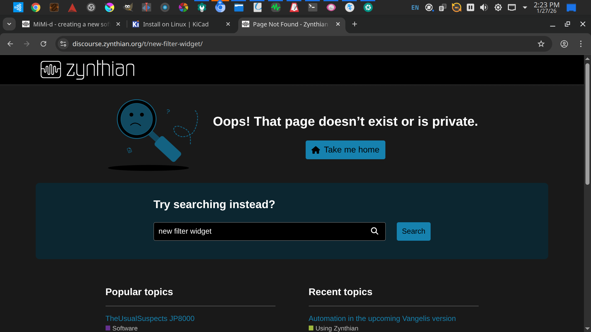

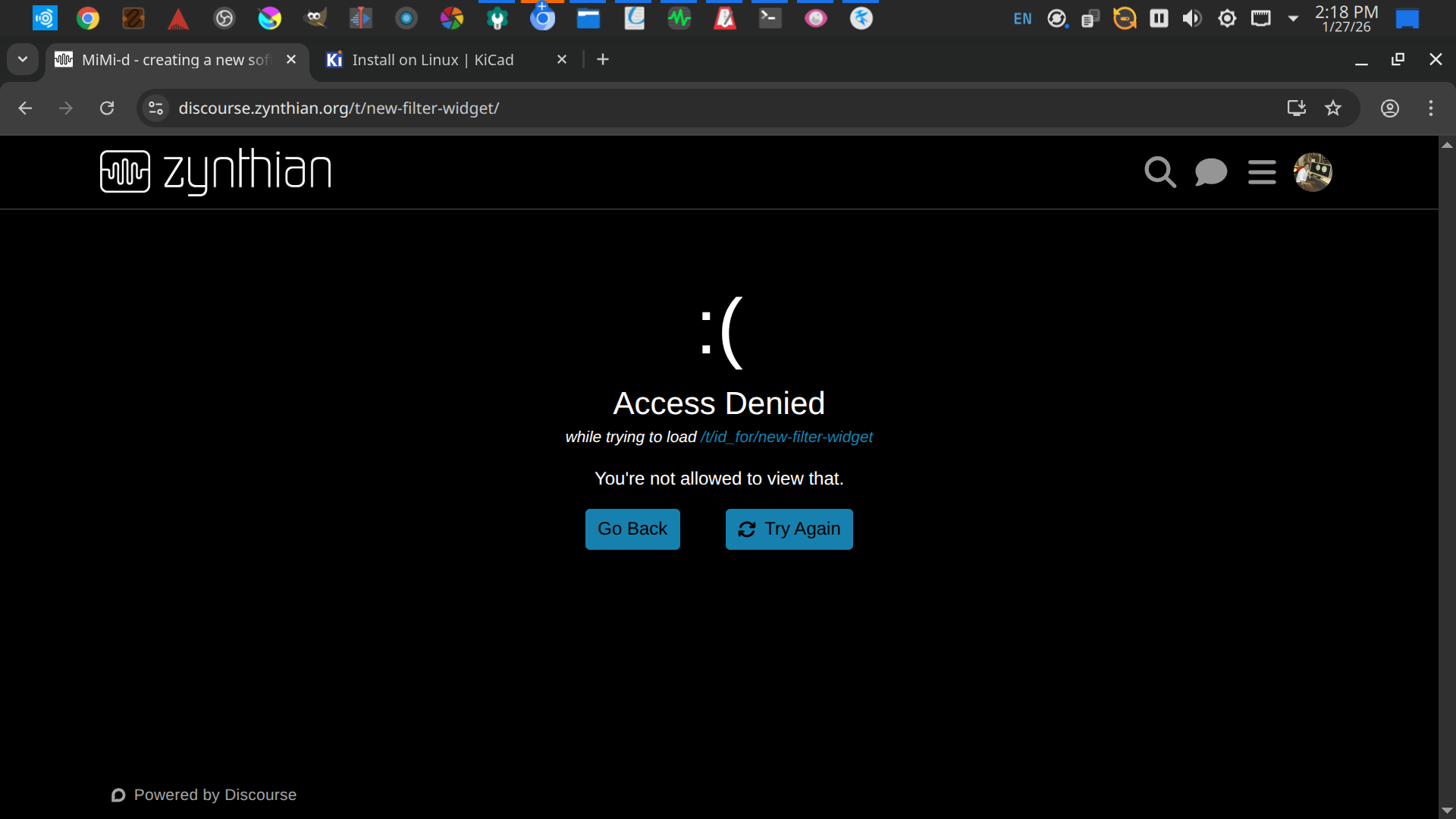

I got Access Denied when I clicked on the link above:
And when I copied the link to the browser URL input line got 404 Not Found or Oops! That page doesn’t exist or is private.:
I wanted to see whether the engines needed to do anything to get the new widget and what I’m getting-guessing is the answer is yes.
Sorry, I think I stripped away too much of the URL when referring to the other thread. I’ve updated the link in the post above (strangely though, the link worked for me).
Hmm, the link still fails for me. I suspect an error in how Discourse handles Links-URLs that has hit some of my posts also.
But anyway, I got my questions answered by searching on new filter widgets, which led to the topic New ADSR envelope widget.

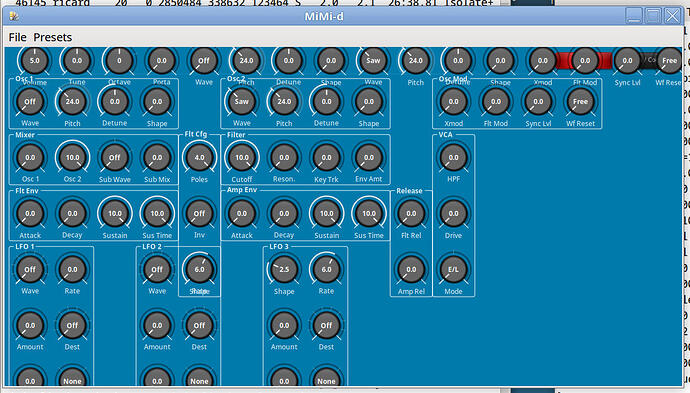

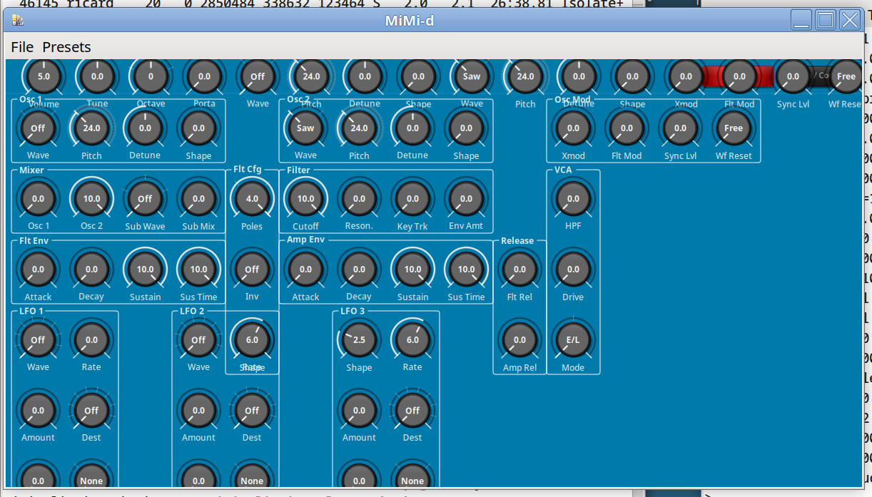

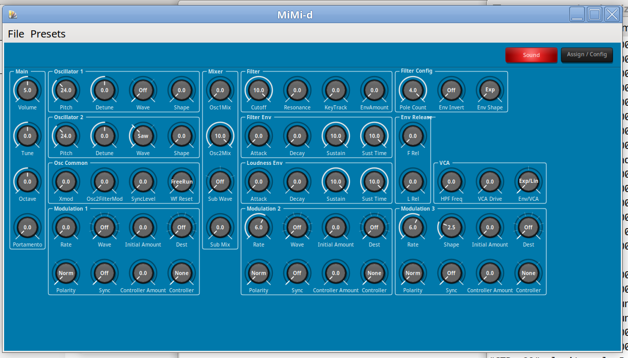

For a while now, I’ve been considering making a proper UI for MiMi-d, not because I miss having one myself, in fact, I really like the Zynthian UI, but because I think it would gain a wider appeal, and would also be useful for getting a wider overview of the settings for a preset. So I spent an evening with Claude Sonnet, and this is what we came up with as a first attempt:
Yes, the layout is a mess with the modules in seemingly random order (not surprisingly since I’ve not yet specified the layout), partly overlapping, and there’s a ghost row of duplicated parameters at the top, but it actually does work. So of course, now the real hard work begins trying to sort this out at make it practical and useful, but at least this prototype makes me both excited and confident that it will be possible to finalize at some point.
Nice work! I’m wondering if there’s an existing open source UI you could recycle.
What GUI toolkit did Claude suggest?
PUGL + Cairo, with PUGL + nanoVG as the runner up.
That would be nice if any knows of anything offhand, but I do have some ideas on how I want it to integrate with the parameter management system in the MiMi-d, so that apart from some placement all the parameters map automatically. Plus I want the UI to be rescalable so it can fit in any window size; I find it frustrating on a laptop to use VNC on Zynthian with plugins that have decided that they need more screen that I have which results in constant scrolling back and forth to get at things.
That said, I have no experience with GUI design in this form so any help would be appreciated.

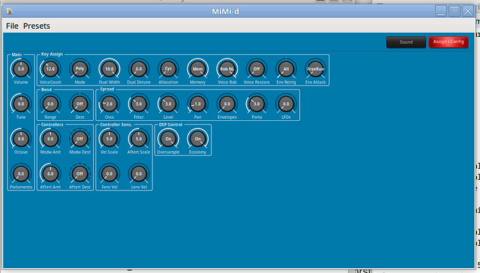

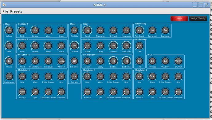

Now this is more like it:
Still lots more to do though …
