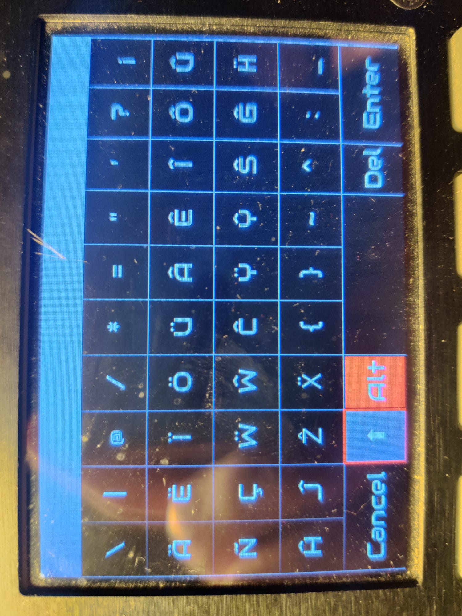

Using the zynthian menus I can type the password but shifted characters are missing.
Using the webconf menu I can see all the networks but I am not offered a menu to enter the password, I just can see the available networks.
Pau
What characters are missing, Pau?
Have you checked the extra character screens when pushing the ā€œaltā€ key in the virtual keyboard?
For instance ā€œ@ā€.
But I see very strange chars with alt which you would seldom use :slight_smile:
But @ is there. I added some weeks ago. It’s in the fourth screen, alt+shift. Top row, char #3 from left.
Perhaps it should be moved to a better place.
They are used in other countries. People like to use strange chars for wifi passwords.
Anyway, I would add any missing char if you tell me.

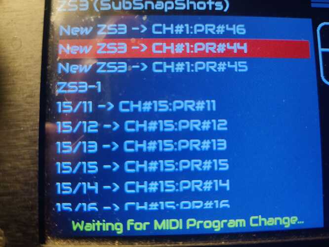

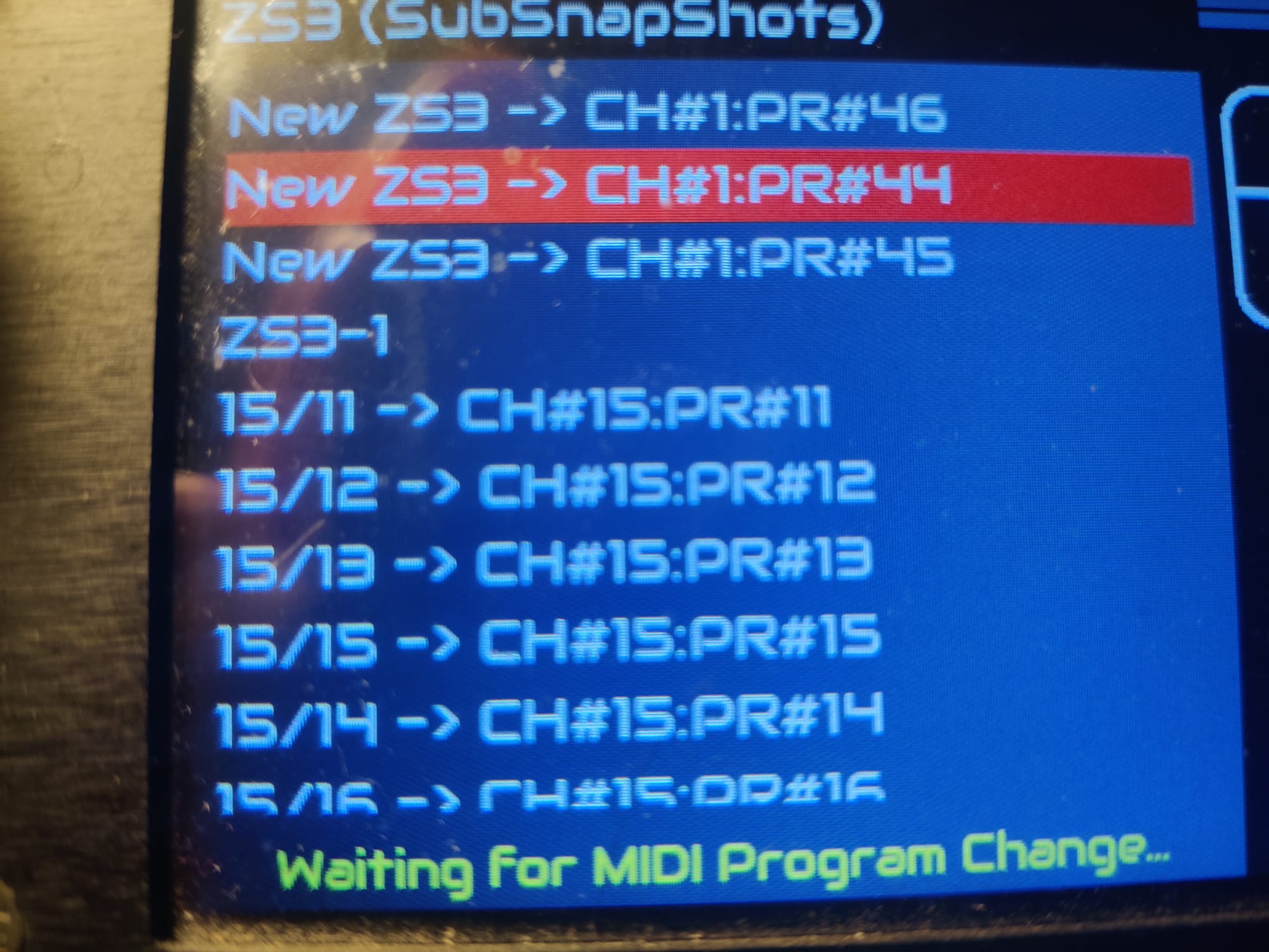

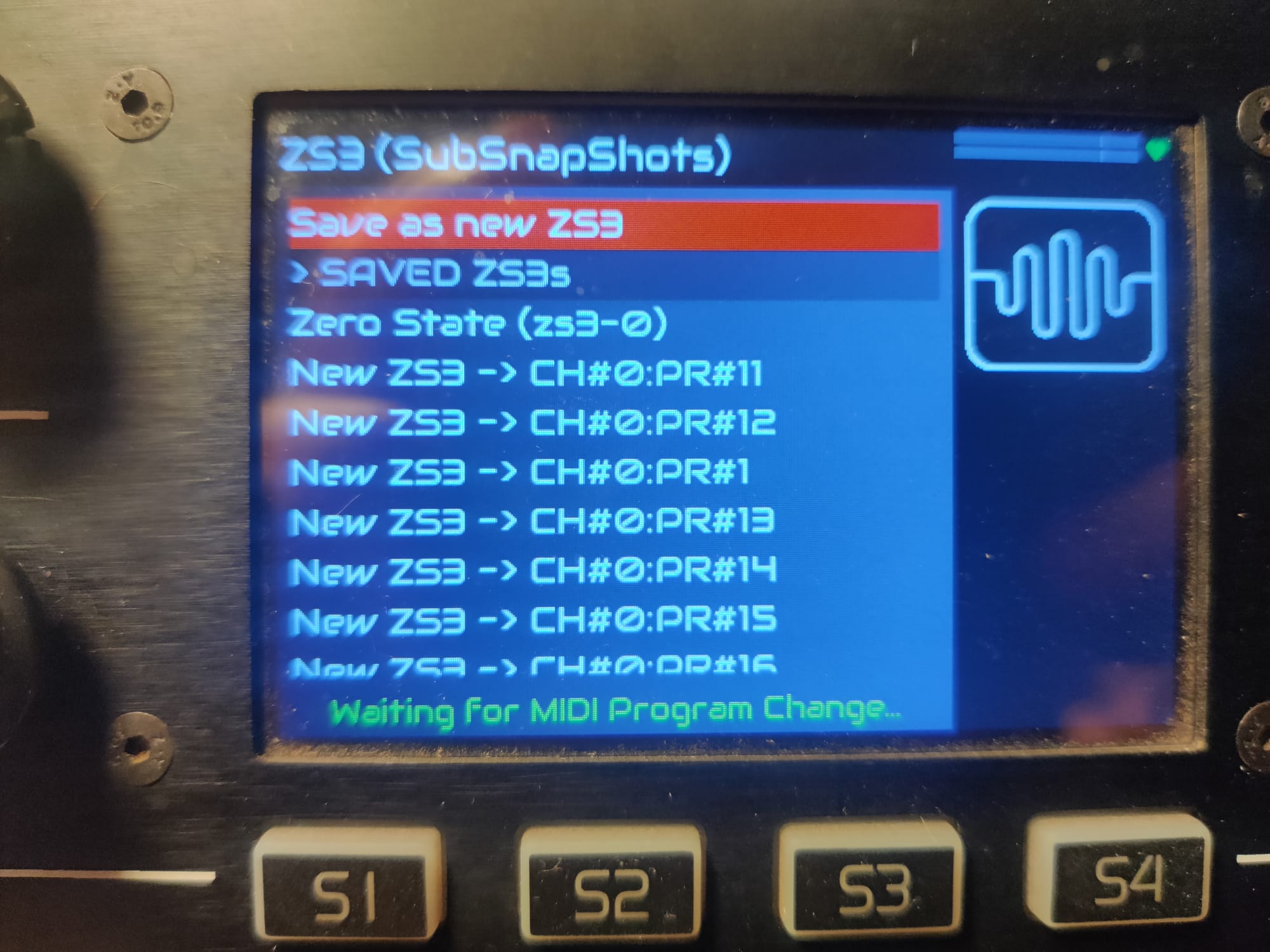

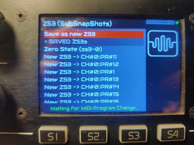

I attach two pics:
-the first one is the list of empty ZS3 after restoring the snapshot
-the second one correspond to the new snapshot I’ve created that includes the 32 subsnapshots that I have added again. I attach it as a reference.

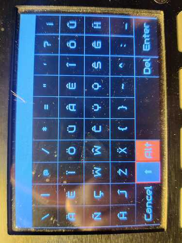

You are right, it’s there!
But the font does not help much, it’s much smaller than the rest :slight_smile:

It looks like the MIDI channel is not being correctly set. In the import, MIDI channel 1 (#0) is used but in your reconstructed snapshot you use MIDI channel 15 (#15).
The names of the ZS3s may also be confusing. In the imported snapshot, they are all, ā€œNew ZS3ā€ where as in your recreated one they have the name: CHAN/PROG.
I agree that the OSK button font is odd and I could only just recognise the ā€˜@’ symbol. Also, it is rather well hidden on the 4th layer!
[Edit] The snapshot you provided does have ZS3 triggered from channel 1 (#0) so the translated snapshot looks correct. Indeed, if I send program change on channel 1, the snapshot responds. (I don’t know if it gives the desired effect - you can tell us.)
