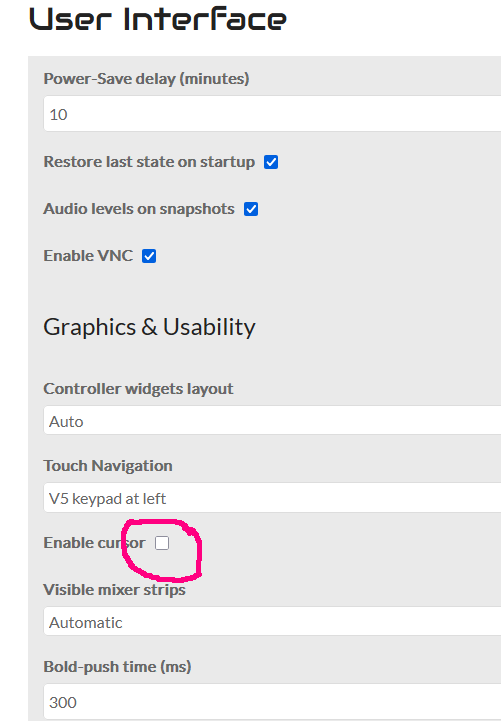

Did you check ā€œenable cursorā€?
its already checked Hans. Someone else reported a similar issue in Nov 24. 7 inch screen touch calibration . They tried using a similar touch screen and appear to have had issues. Enable cursor removes or adds the cursor. I have a mouse connected to the set up. I just dont have touch control even though it is as I say working on some level. The touch calibration tool definitely is seeing it partially

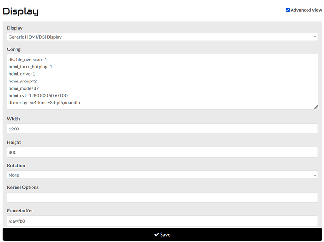

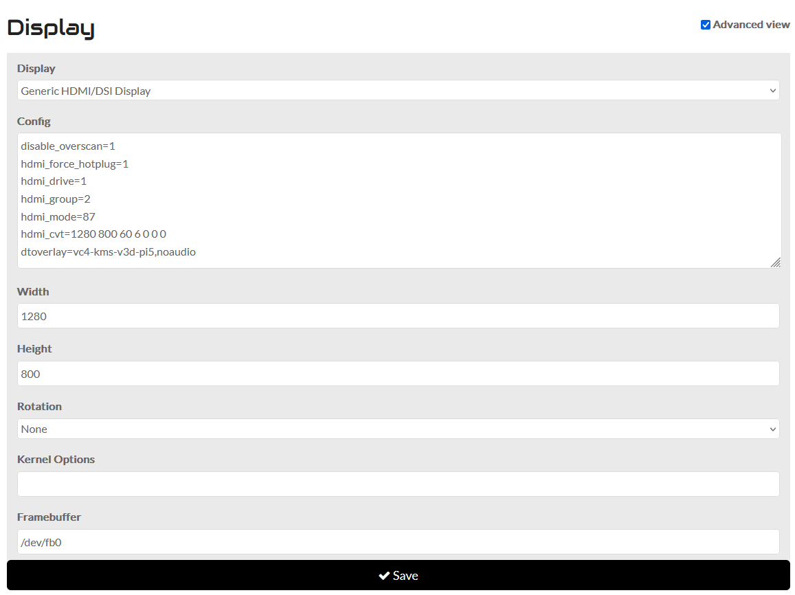

How does your display config look like? Don’t know if it helps, but I set up my screen using one waveshare 7 inch ā€œtemplateā€ and adjusted the values according to my model.
Guess in your Generic setup the field where youre supposed to enter /boot/config.txt stuff is empty by now. Also enter your resolution also in the corresponding field. Can look something like
hdmi_group=2
hdmi_mode=87
hdmi_cvt 1024 600 60 3 0 0 0
hdmi_force_hotplug=1
For me in the beginning the touch seemed no not work because the screen resolution was matching to some arbitrary touch resolution. Maybe your touchscreen works but you hit some unrelated blank screen areas.
EDIT: Mine is looking like this:
@hannesmenzel thank you for this. I have configured the Generic setup as you suggested. The TFT is a Waveshare clone. The rPi mounts to the back of it and has an USB connector to mini din TOUCH connector on the TFT. There is a USB c one also on the side of the TFT.
I have just been playing with it and powered it through the rPi (instead of the power connector on the TFT itself). I then pulled the USB → mini din connector out and reseated it and suddenly touch started working. Given this is a faff I have connected the USB to the USB c TOUCH point on the side of the TFT. Touch wont work on boot initially, however once booted i can pull the connector in and out and touch starts working. Its not elegant and i wonder why this action results in the touch starting to work. Does USB do a refresh when i do this that then enables touch? I tried touchscreen calibration and that works fine now (as I thought it would).
