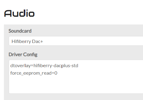

if i set HifiBerry DAC+ as audio card this is the result of a aplay -l:
root@zynthian://zynthian# aplay -l
**** List of PLAYBACK Hardware Devices ****
card 0: vc4hdmi0 [vc4-hdmi-0], device 0: MAI PCM i2s-hifi-0 [MAI PCM i2s-hifi-0]
Subdevices: 1/1
Subdevice #0: subdevice #0
card 2: vc4hdmi1 [vc4-hdmi-1], device 0: MAI PCM i2s-hifi-0 [MAI PCM i2s-hifi-0]
Subdevices: 1/1
and UI log:
May 19 13:38:13 zynthian startx[3127]: jack server is not running or cannot be started
May 19 13:38:13 zynthian startx[3127]: JackShmReadWritePtr::~JackShmReadWritePtr - Init not done for -1, skipping unlock
May 19 13:38:13 zynthian startx[3127]: libzynmixer: Failed to start jack client: 17
May 19 13:38:13 zynthian startx[3127]: libzynaudioplayer exiting… done!

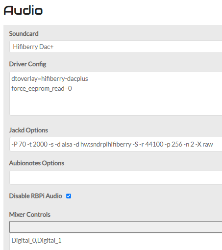

Are you sure you have set audio device to HifiberryDac+, because as is it still give HifiberryDac light as audio device ?
system reboots continously with ERROR
May 19 13:44:12 zynthian startx[2228]: audio_reservation_finish
May 19 13:44:12 zynthian startx[2228]: Cannot initialize driver
May 19 13:44:12 zynthian startx[2228]: JackServer::Open failed with -1
May 19 13:44:12 zynthian startx[2228]: Failed to open server
May 19 13:44:12 zynthian startx[2221]: Cannot connect to server socket err = No such file or directory
May 19 13:44:12 zynthian startx[2221]: Cannot connect to server request channel
May 19 13:44:13 zynthian startx[2221]: Cannot connect to server socket err = No such file or directory
May 19 13:44:13 zynthian startx[2221]: Cannot connect to server request channel
May 19 13:44:14 zynthian startx[2221]: Cannot connect to server socket err = No such file or directory
May 19 13:44:14 zynthian startx[2221]: Cannot connect to server request channel
May 19 13:44:15 zynthian startx[2221]: Cannot connect to server socket err = No such file or directory
May 19 13:44:15 zynthian startx[2221]: Cannot connect to server request channel
May 19 13:44:16 zynthian startx[2221]: Cannot connect to server socket err = No such file or directory
May 19 13:44:16 zynthian startx[2221]: Cannot connect to server request channel
May 19 13:44:17 zynthian startx[2221]: jack server is not running or cannot be started
May 19 13:44:17 zynthian startx[2221]: JackShmReadWritePtr::~JackShmReadWritePtr - Init not done for -1, skipping unlock
May 19 13:44:17 zynthian startx[2221]: ZynMidiRouter: Error connecting with jack server.
May 19 13:44:18 zynthian startx[2221]: Started libzynaudioplayer using libsndfile-1.2.0
May 19 13:44:18 zynthian startx[2221]: Cannot connect to server socket err = No such file or directory
May 19 13:44:18 zynthian startx[2221]: Cannot connect to server request channel
May 19 13:44:18 zynthian startx[2221]: jack server is not running or cannot be started
May 19 13:44:18 zynthian startx[2221]: JackShmReadWritePtr::~JackShmReadWritePtr - Init not done for -1, skipping unlock
May 19 13:44:18 zynthian startx[2221]: libzynmixer: Failed to start jack client: 17

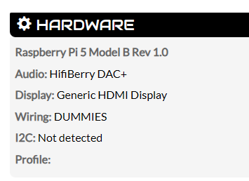

well, settings looks ok but now the hardware is even not recognized by alsa. I’m stuck sorry
I Will open an issue
Does the same hardware work with Stable version of Zynthian?
If no, then Does the same hardware work with non-Zynthian software, either Raspberry Pi OS by itself or something like Blokas Patchbox:
