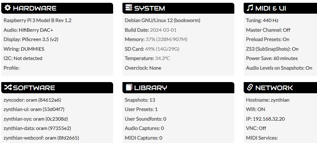

I just installed ORAM on Raspberry PI3, Hifiberry Dac+, LCD touch 3.5" XPT2046 TFT
Final result is white screen. Not possible to use webconf connecting notebook by network cable.

It looks like you have set the screen correctly to be able to see the error screen. If you have chosen the right soundcard and rebooted and still see the error then it is likely the GPI configuration. What GPI do you have and what is the configuration in webconf hardware?

I would like to solve Error that I think is generated by wrong display setting
