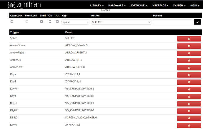

By default the key mapping is logical (to me) if you know the reason for it. On a standard UK QWERTY keyboard, the < > keys are near the bottom right. These are mapped to the nudge up / down of the 4th encoder (SELECT on V4). Modifier SHIFT makes them act as 3rd encoder. Ctrl makes them act as the 2nd encoder and SHIFT+CTRL makes them work as the 1st encoder. The 4 keys directy above these are I, K, O, L which are mapped to the switches on the 4 encoders (1st switch = I, 2nd switch = K, 3rd switch = O, 4th switch = L) so that they mimic the location on a V4. The Numeric keypad also has logical mapping but I rarely use that (although I did buy a wireless nemric keypad to implement and test this).
This default key binding (that can of course be changed in webconf) allows control with one hand hovering over those 6 keys and another hand pressing the shift/ctrl modifiers. It works well for me and I now have the muscle memory for this to be second nature.

After playing a bit with the keyboard, I can control some functions, also the knob values up and down. The knob buttons do not work. Instead, the key input freezes for a while, then returns to normal function. Also the “Select” function is not working, when mapped to “Enter” key for example. I have cleared the full mapping list via webconf and try to implement one key after the other.
You don’t want action SELECT. You want ZYNSWITCH 3.
You don’t want parameter 3 with your arrow actions.

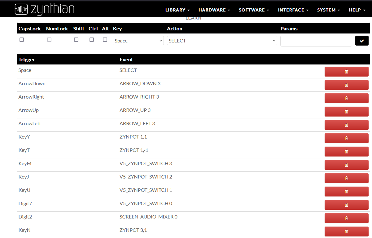

the parameter 3 on the arrow events was added by the Zynthian itself by actvating Profile V5. The arrows work as expected. I tried this profile to make V5_ZYNPOT_SWITCH working, but it does not work. The top entry “SELECT” is also not working. I think I have to learn a bit with the keyboard settings.
Oops! Typo in my previous comment (now corrected). CUIA SELECT is not the required action. This is a very common mistake that users make so maybe we should think how to mitigate it. If you want to emulate the press of the 4th encoder (SELECT on V4) then you need ZYNSWITCH 3 which binds the key to the action associated with the 4th (zero based index, hence param = 3) switch which is hardcoded as the V4 SELECT switch. You can do similar with other ZYNSWITCH values. The first four (0…3) are hard coded to the encoder shaft switches of a V4. The rest are defined in Wiring Layout. A slight confusion is that wiring layout shows switches 1, 2, 3… but ZYNSWITCH references these with parameter 4, 5, 6… I would like to simlify this and make all the trigger mapping consistent and configured in a similar way - but not today…

With “SELECT” I mean the “Yes/Sel” Key action on a V5 kit. It confirms a previous selected action, like “Enter” or “Return” event on a computer keyboard. But it is not working in the key binding list right now, when mapped to space or enter key. Or I maybe use the wrong event. On V5 the “yes” button generates the necessary event without problems. Also the knob switches can send the confirming event to enter the previous selection.
Read my previous comment. The CUIA command, SELECT is not the CUIA command you want.
OK, thanks for open my eyes… ![]()
OK, I´m moving forward. The ZYNSWITCH works so far.
