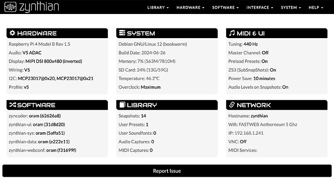

[Edit] Also, will you paste your webconf dashboard screenshot here?
[Edit] Also, apply the updates. There may be a difference that you are experiencing that we won’t see because we have the updates applied.

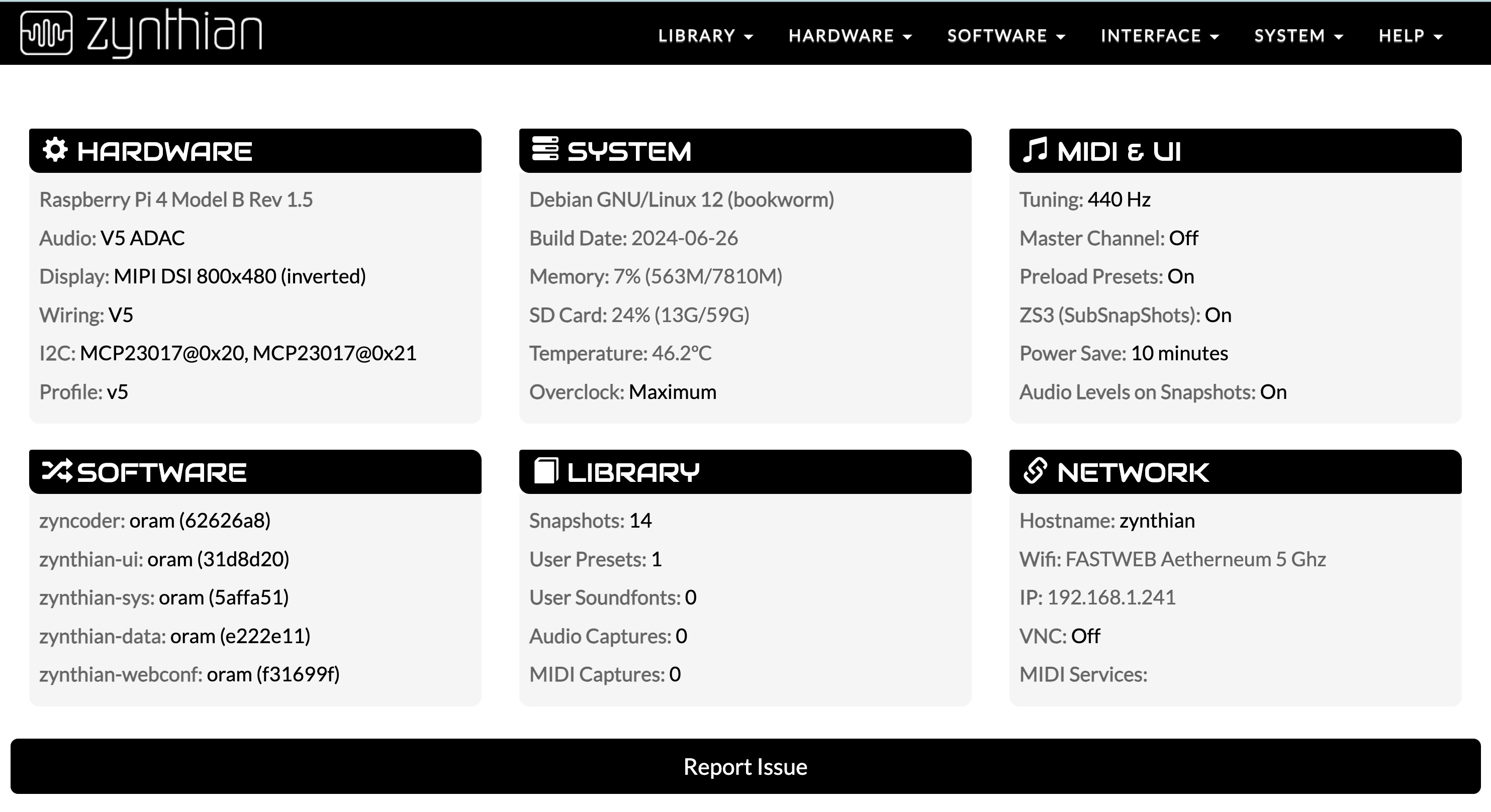

See dashboard attached:
