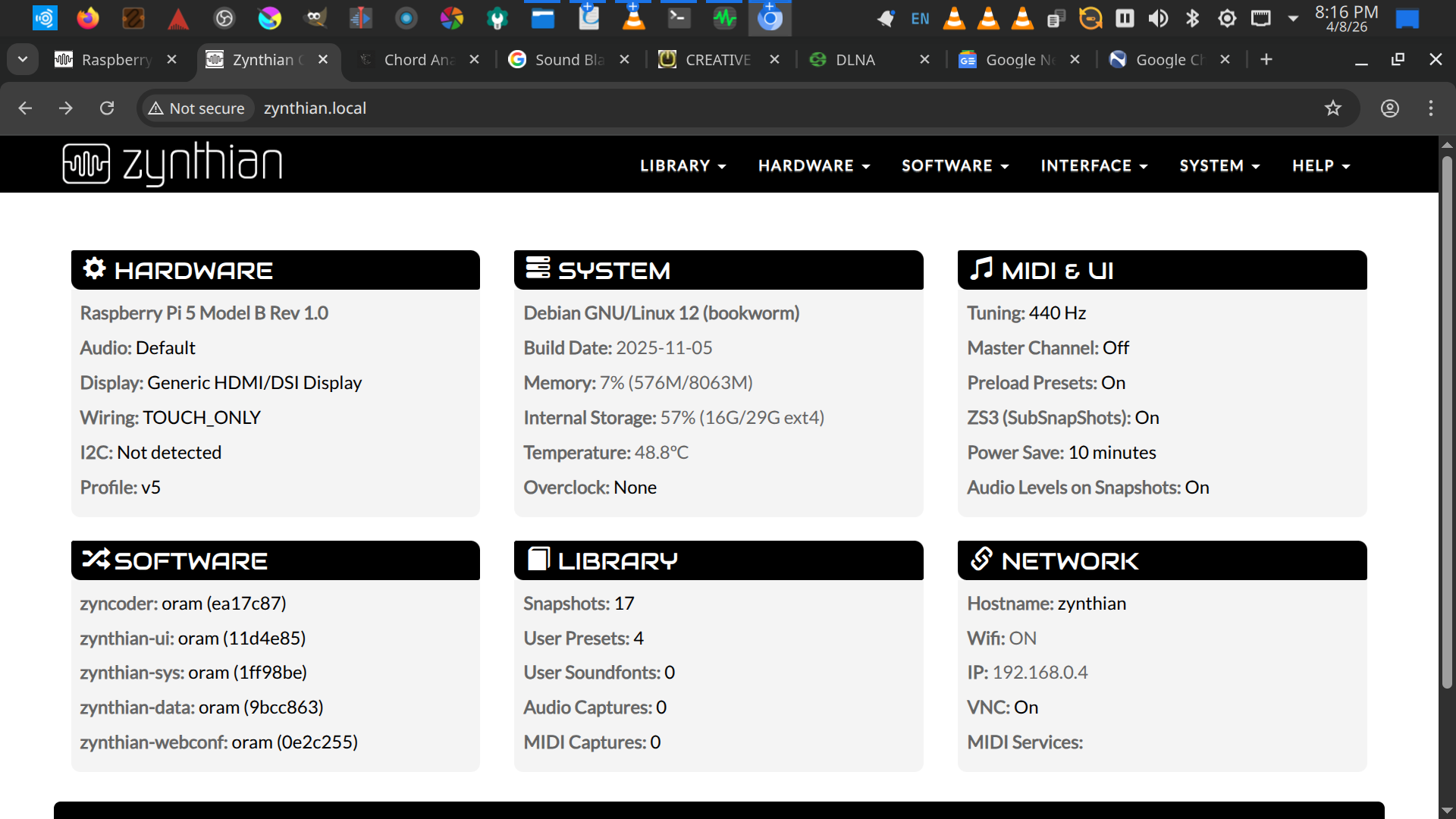

I have RPi5 and Touch Display 2, and I want to rotate the screen for Landscape.
I start with a fresh Oram and update to Oram staging and I have a working Zynthian with the only problem showing the screen in Portrait mode. I try to implement what I see as the simplest essentials detailed above, but with the changes, Xwindows and of course therefore Zynthian, doesn’t start. The Xorg.0.log file shows:
[ 12522.950] (==) Using system config directory “/usr/share/X11/xorg.conf.d”
[ 12522.950] Parse error on line 1 of section InputClass in file /usr/share/X11/xorg.conf.d/90-monitor.conf
The Section keyword requires a quoted string to follow it.
[ 12522.950] (EE) Problem parsing the config file
[ 12522.950] (EE) Error parsing the config file
[ 12522.950] (EE)
Fatal server error:
[ 12522.950] (EE) no screens found(EE)
This is the contents of my /usr/share/X11/xorg.conf.d/90-monitor.conf file via copy and paste:
Section “Monitor”
Identifier “DSI-1”
Option “Rotate” “right”
EndSection
The only other change I made to the Zynthian, I think, was adding these two lines to the Display Config in webconf:
disable overscan=1
dtoverlay=vc4-kms-dsi-ili9881-7inch,dsi1,swapxy,invx
If I rename the 90-monitor.conf file XWindows immediately starts up and all is well, except, of course I’m still in Portrait Mode.
This is with the Touch Display 2 plugged into the DSI0 connector, the one closer to the Ethernet port.
Does anybody else see what I’m doing wrong? I sure don’t. And if not, any suggestions to help figure it out? Many thanks.
Here is the Dashboard from webconf:
