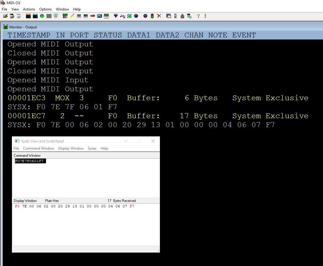

Hello @HansR
If you have a PC with windows you can use Midi-OX to see if your device responds to universal device inquiry
For my LP mini MK3 I get
If you are on other OS there are probably tools that can make the same job
Hope it can help
Alain
Hi @AL1-1956
Thanks for the tip, the device responds to universal device inquiry,

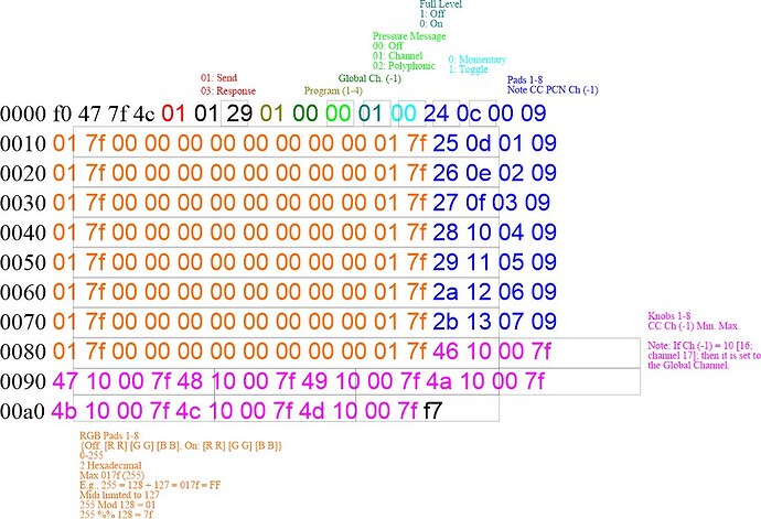

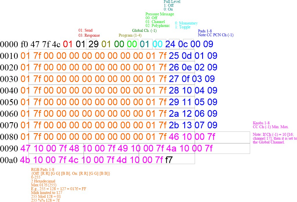

I’m lucky, I found the complete structure:
Problem is not the content, but timing I’m afraid. But that is all part of the hobby :grin:
