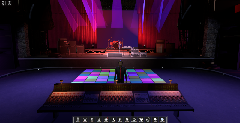

I am trying to get zynthian to send midi TO my windows PC.
So net_out is connected to rtpmidi_in which is the correct wiring in patchage i.e. same connections of Qmidinet. So I want signals to pass from my controller, through zynthian to my windows machine and into VR to control my Light Effects.
right now I have to use ttymidi to do it and I would like to use rtpmidi instead.
Yes, I have been using patchage to diagnose and wireshark only shows midi going into Zynthian but not out… Only packets come into my windows pc from Zynthian are only the synchronizing packets. None that actuall contain the payload are coming through. using RTP-MIDI from between 2 windows machines, shows the trafic going both ways.
