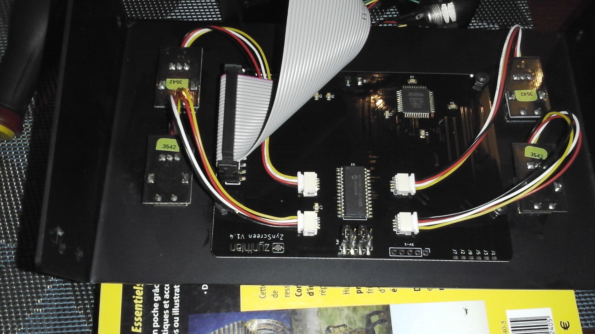

OK! Don’t worry about it … simply tell me what kind of encoders are you using. Send a photo, please.
They are the 3542 type (so says the label)…sorry about bothering you with this but I wouldn’t know where to find this kind op part.
This is a photo I took last week, so you can check the type.
Perfect! I will send you 2 spare controllers …
