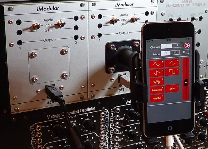

About USB audio interfaces : if possible, use something based on the Texas Instruments PCM2901 chip.
It was the chip I used in the iModular CV interface I designed a few years ago, and I found it was giving an excellent latency, much lower than audio interfaces based on microcontroller
The PCM2901 uses a full hardware USB controller (it does not run any code), which removes the extra buffers needed by many microcontrollers, giving lower latency
However, I have to say that audio quality is a little bit lower than with the HiFiBerry (PCM2901 chips are “only” 16 bits, while the HiFiBerry DAC is 24 bits)
