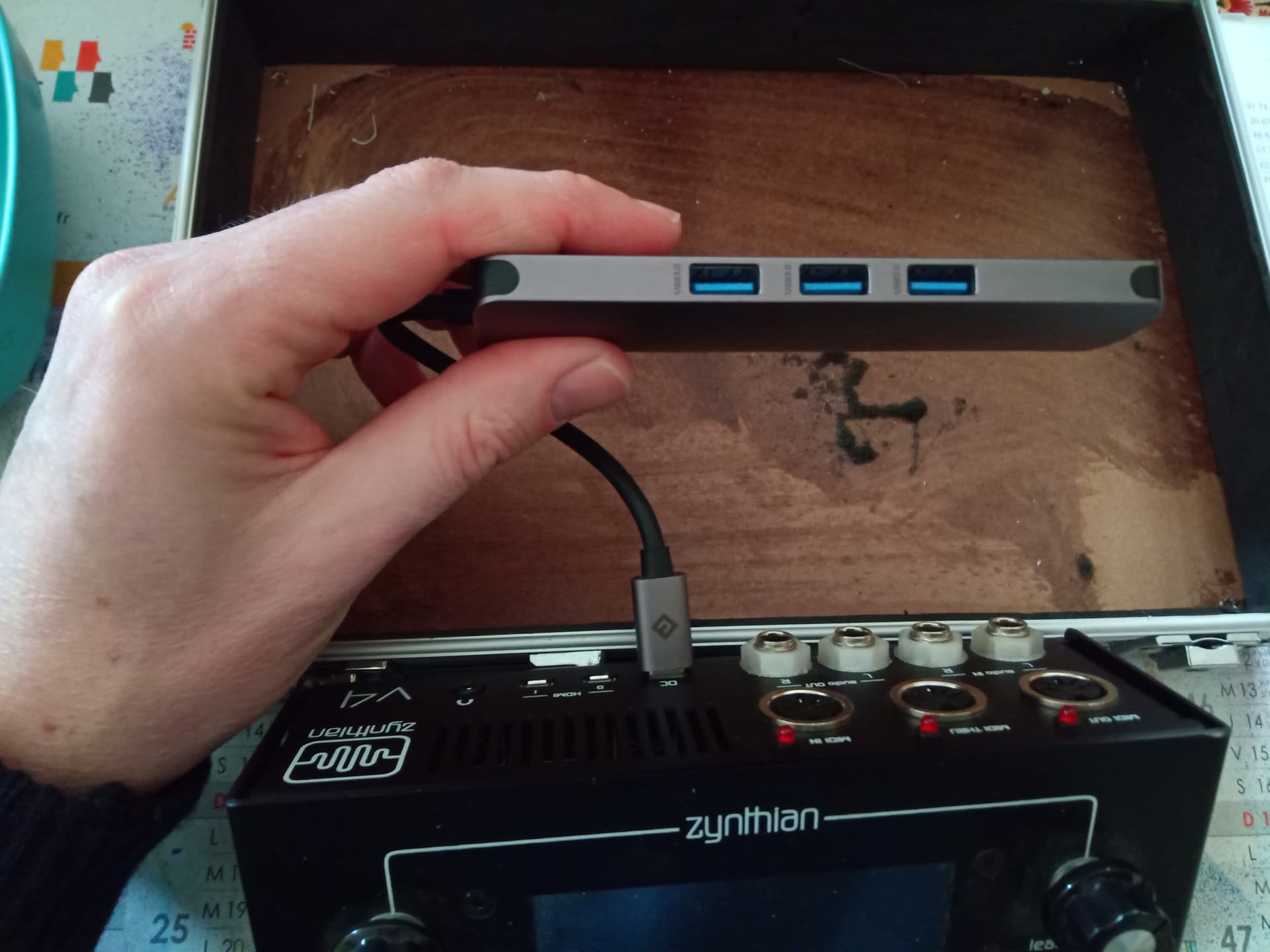

My USB - C hub doesn’t accept USB devices if I put it in the back of my Zynthian RPI4. Do you know if it and hardware limitation or a software one ?

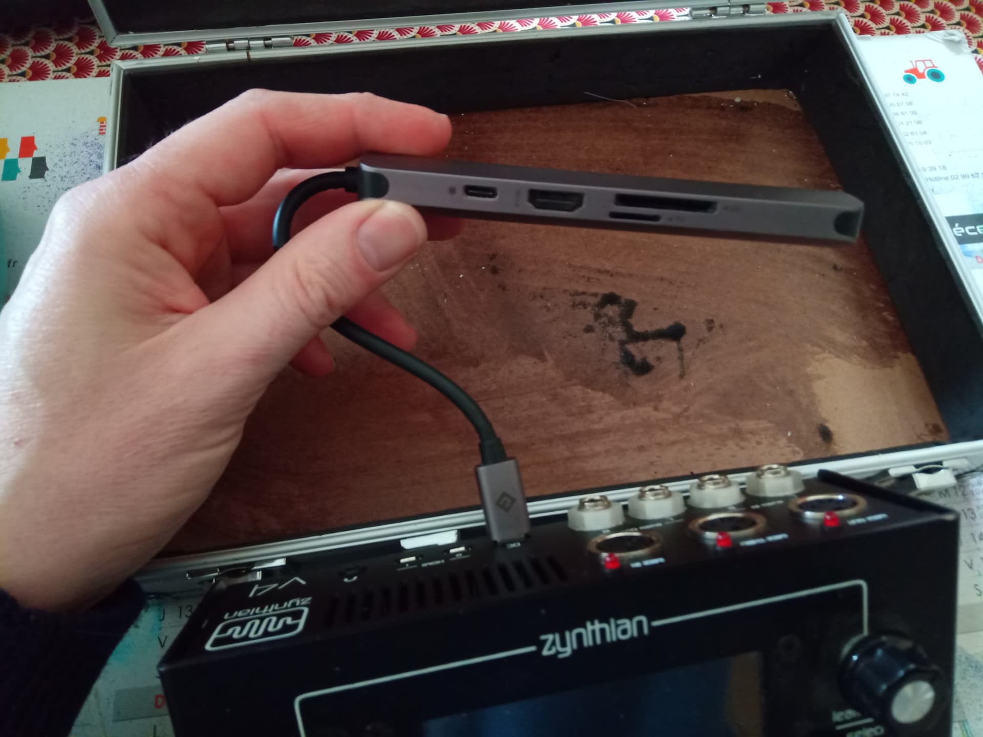

It looks like it’s not a powered hub that you’ve got. I’m curious: how do you power the Pi with the hub plugged in ?
I’m reading your sources right now :slight_smile:
There is an other USB-C on the hub to put the power supply

Oh ! This line work !!
dtoverlay=dwc2,dr_mode=host
Even the Ethernet port ok my hub is working !!
(I guess the SD port too but don’t know how to check)
