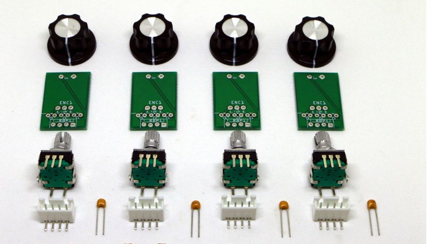

This is what the build guide says I should have received:

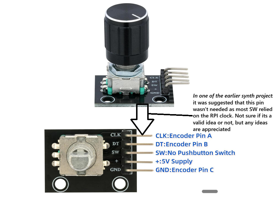

As yuo can see a little soldering and youll have encoders with JDT onnectors on them, but THIS is what came in my kit: (this is a standard Inet image not a photo of mine)
5 pins on the encoder 4 lines on the JST connector. as noted, one of the other synths I put together suggested that if using something like the PI you will usually rely on the sbc clock, so that pin wasnt really needed.
Havent tested it yet, but getting close. However my small electronics knowledge pre dates the internet, so if anyone has any ideas, or if youve used these encoders let me know.
I DO have some 3 post encoders, but nothing with 4.

We (and by that I mean the Zynthian community) have gotten people’s DIY Zynthians working with lots of different encoders - you can search on encoder, zyncoder, etc to read about em, so helping to build from an old official kit should be easy.

Anyway, i’m 100% sure we NEVER sold this kind of stuff. In the pre-V5 era, we always sold encoders like the ones from the first picture. If you have a different stuff, you didn’t buy an official zynthian kit, and the instructions from the wiki tutorial probably don’t match your hardware.
Anyway, please send real pictures of the parts over your desk and we would try to help you as much as we can.
