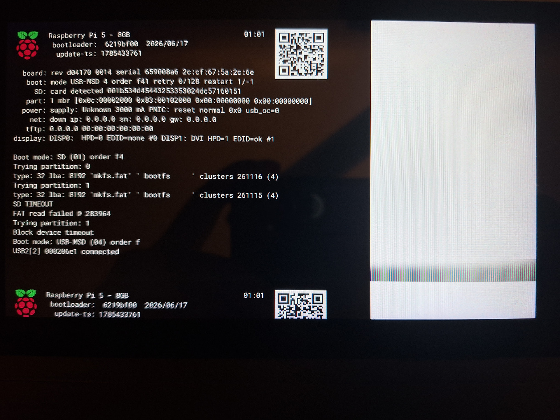

OK. Did that with a fresh SD.
After first boot: Only flickering disco lights on keypad. No SSH, no network, hang-up.
At this point it would not be possible to do anything. Maybe a serial console exist, but I have no debug cable with me.
So, like usually, when trying to boot with anything attached to GPIO plus connected HDMI+USB, took out the card and configured the display in config.txt. This step would not be necessary, if I disconnect the GPIO completely from Pi5 before first boot.

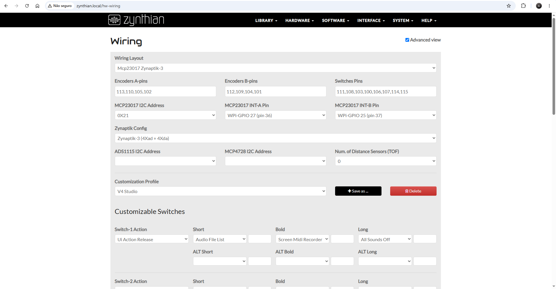

Hello Zynthian community,
My setup is based on the V4 Studio wiring layout (Mcp23017 Zynaptik-3, I²C address 0x21, with encoders and switches connected to GPA/GPB). The hardware platform is a Raspberry Pi 5.
After the latest system update, the knobs and switches stopped working. Previously everything worked fine with this diagram and profile, but now the logs show errors related to the MCP23017 interrupt callback.
Here is the profile I am currently using:
To complement this information: I reinstalled the Vangelis image, and with that fresh installation the knobs and switches worked correctly. However, as soon as I ran the system update, they stopped working again.
Could you please confirm if there have been changes in how Zynthian interprets GPIO pins (WiringPi vs BCM) on the Raspberry Pi 5? Is there a recommended fix or adjustment so that the encoders and switches work again after updating?
Thank you for your help!

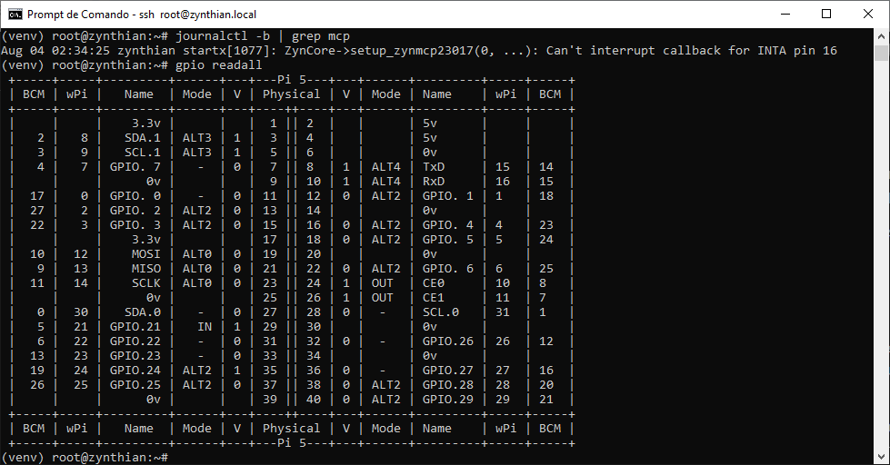

(venv) root@zynthian:~# (venv) root@zynthian:~# journalctl -b | grep mcp
Aug 04 02:25:13 zynthian startx[1034]: ZynCore->setup_zynmcp23017(0, …): Can’t interrupt callback for INTA pin 16
Hi, I have exactly the same setup (V4 with Raspberry Pi 5) and same happened for me. Now I’m with a fresh install - evertyhing works again, but I certainly won’t do a system update now knowing it’s likely to break again. So also looking for a solution!
I did exactly what you mentioned: a clean installation on the new image with Raspberry Pi 5 and Zynthian V4. After that, everything started working again — the GPIOs were recognized and ZynCore initialized without errors. So yes, this solution worked for me as well, and the system is stable again.
Thank you so much for sharing your experience, because that’s exactly what helped me fix the issue too! :folded_hands:
Someone with a RPi5 V4 should raise a github ticket so that this gets looked at. The hardware platform is not a standard supported by zynthian labs so needs community engagement. It won’t be detected by any of our normal regression tests.

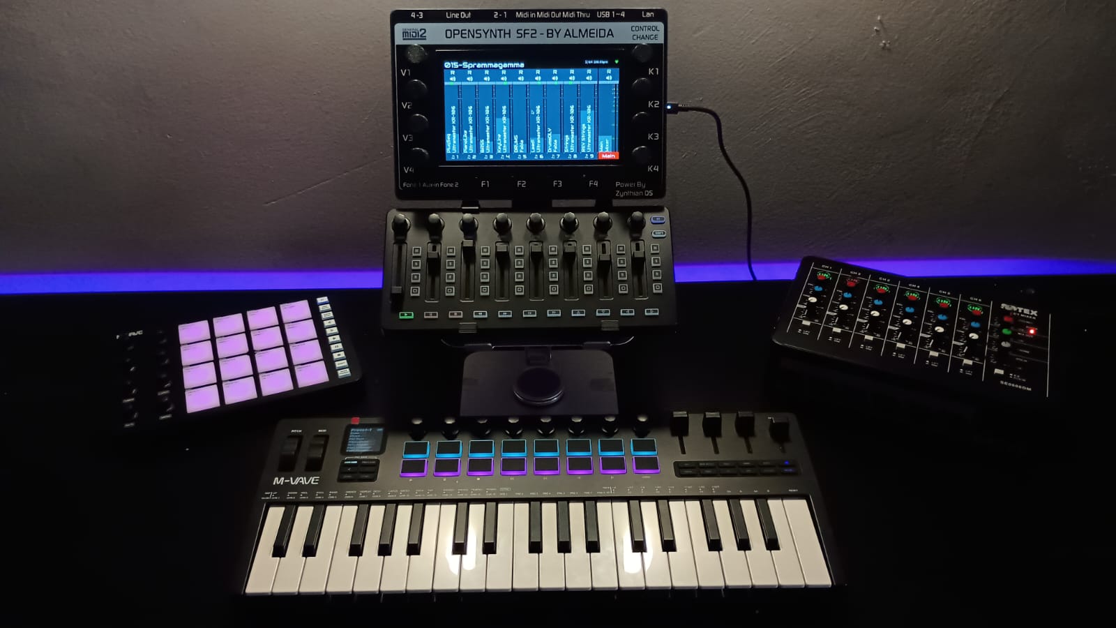

Hi vangelis lovers!
While testing some RT-safe improvements in the deeps of sequencer low level code, i’ve played the sprammagamma snapshot at 420BPM. I must say there was not a single XRUN while playing it in my V5 Pi5. It behaved Rock Solid!!
You can listen the result by yourself:
I suppose it’s really far from the author’s intention … but whoaooo! What a bizarrous japannese-girl-thrash-metal-jam-or-whatever-the-hell it sounds like!! :rofl:
With all respect!
