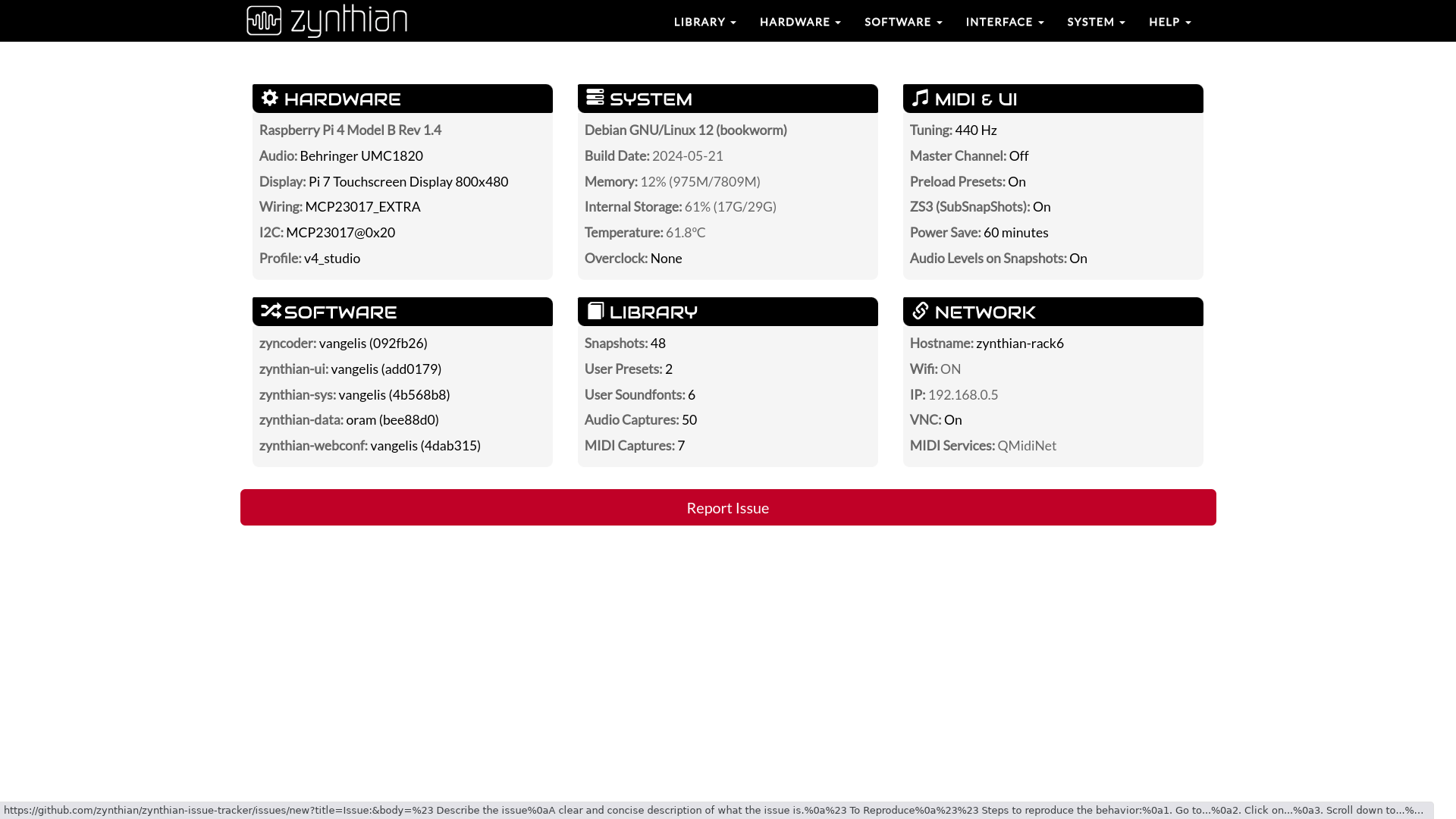

I have raised this, via the Report issue Button on the webconf home page.
