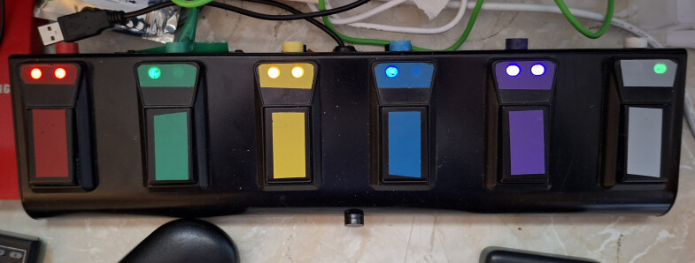

A Blue Pill will power LED strips from GPIO pin directly, whilst a Pi Pico likes a diode in line to drop the voltage of supply just enough to cross the threshold. Other wise the Bugera pedal transited from Blue Pill to Pico in an afternoon… ( Someone is beginning to sound a bit like a fan boy ain’t he..? I’ll give myself more soup . . . )
The Grey switch loops thru’ the other pages, Red page 1, Green Page 2 etc The Menu Led flashes every second to tell me it’s alive.
The other five switches can, on each page, be configured for
Momentary (single LED on, both on when pressed)
Toggle (Both LEDs on or off) operation
Nothing NO LED’s → not configured.
. And hopefully will label the functions on the Zynth GUI.
