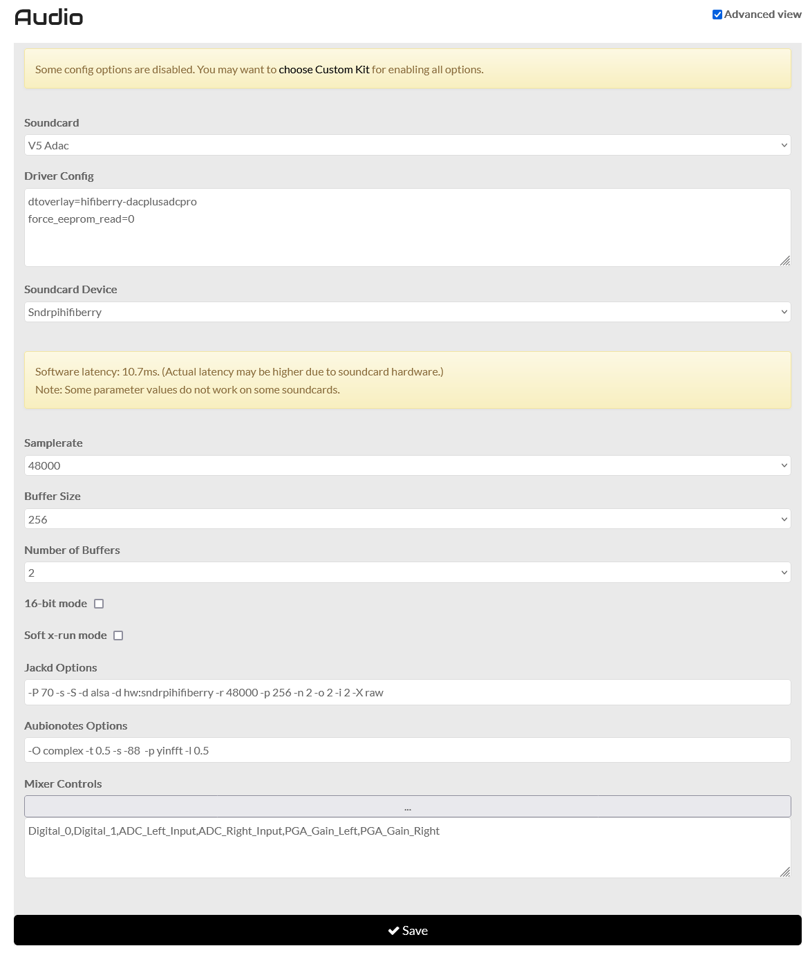

Machine seems cool and have never felt heated. Normally around 35 when ever i look. Like right now…
Tested now with one USB plugged in, Not overclocking, PT setting:
XRun output for a couple of seconds:

My RPi5 has Pianoteq 8.3.1 Stage Trial. (I have not added a licence or updated this machine yet.) As mentioned in your last post, this does not seem like an issue with PT but instead with the V5.1. Piantoeq has been quite useable on RPi3 and RPi4 when running at half internal samplerate with no xruns and it works fine with a properly cooled RPi5 at full internal samplerate. You have been experiencing suboptimal performance with the same sfotware as other users so your this looks like an issue with the hardware.
Are you using SD of NVMe? If SD then what make and model of SD card? How confident are you that it is a genuine SD and not a clone? (There are many of them. A SD at reduced cost or from dubious supplier will often fake with substandard performance and possibly incorrect size.)
How is the CPU performing? Run htop in a console and watch the CPU core meters (0…3) whilst playing. You should expect all 4 cores to be failry idle with PT loaded but not playing (about 2% but peaking to about 8%) and to increase to approx. 30% when playing Pianoteq.
Memory should sit around 1G.
Run jack_cpu_load which shows how much CPU that JACK is using (kinda). This should sit around 5% when idle and increase to about 30% when playing PT.
What the temperature for a while whilst idle and then playing. You can use this command to show the core temperature every 2s: watch -- 'vcgencmd measure_temp'. Expect to see a temperature below 50° whilst idle and playing.
Check the jack routing with jack_lsp -c. This shows what is connected to what. It may be a bit cryptic and it is probably not worth me explaining the possibilities so just post the result and I will take a look to ensure it looks sensible.
Post your /zynthian/zynthian-my-data/snapshots/last_state.zss. There might be something odd causing an issue.
Post RPi info: cat /proc/cpuinfo.
Post bootloader info: rpi-eeprom-config and rpi-eeprom-update.
As I understand it, you have an official zynthian V5.1 with RPi5 (what size RAM?) running zynthian oram with a USB MIDI keyboard connected. You have connected Tascam US-16x08 but should disconnect and configure as V5 kit whilst doing these tests.
Disable hotplug USB and see if you get different results.

It so hard to let go off this, so i did some tests
Oops, running at 3-4 when not playing and 60-90 when playing!
When idling results are like you described, but when playing the cores are at 65-100% Mem stays at sub 1GB
Temp around 32 when idling, and stabilizing around 37 when playing (im pretty sure i did a decent assembly with thermal padding and all :slight_smile:
