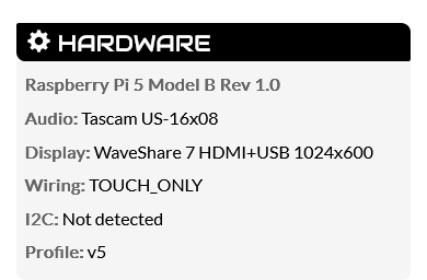

What hardware and configuration do you have?

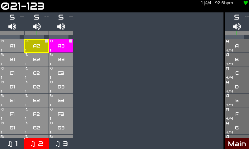

Definitely much better for me. I just noticed that the Tempo in the upper right windows now is wrong. In this project should be 90 instead of 120. In the Tempo window everything is ok, and when playing timing is correct. I tested another project and the problem is the same. So it seems that in the pattern window Time is always 120.
Me?
custom RPi5 Zynthian with V5 keypad at right
This is due to changes in a recent commit. I have commented in github and @jofemodo can consider how to resolve this. (The change could be reverted or an explicit update of tempo could be done.)

I don*t have real buttons, only buttons on display
Me too! I did all of those actions with a 5" capacitive touch screen only, configured with V5 keypad on right. Touch screen button. Which step is behaving differently?

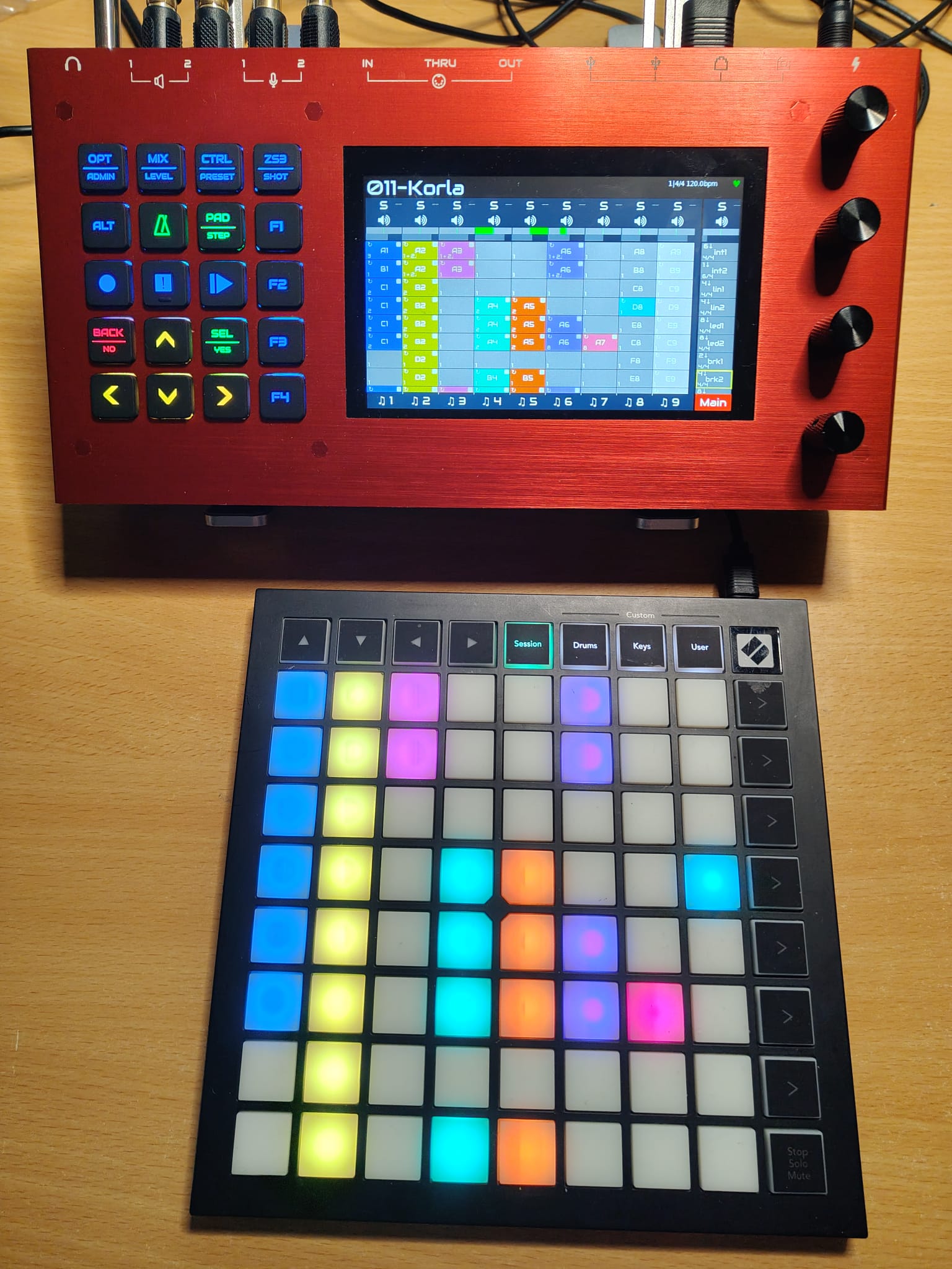

I found out that this is not working. When i reload the snapshot pads are still grey but the play mode is LOOP and playing phrases in sequence is chaotic, with patterns playing from different rows. It seems that setting again gray patterns in loop mode and giving them back colors can solve the problem, so i’m doing again everything in this way.
