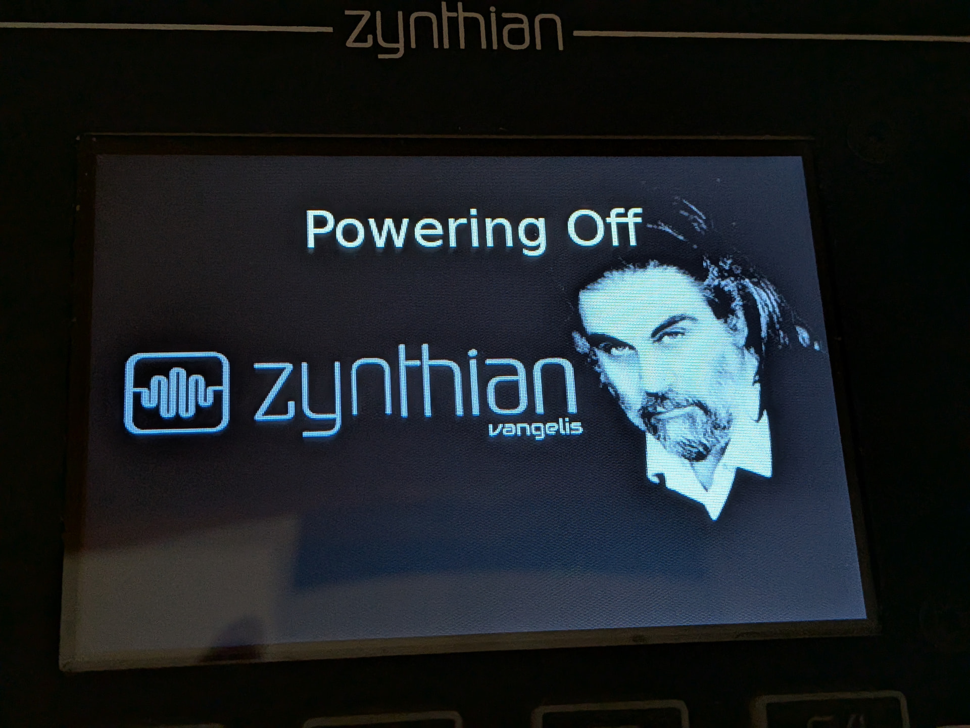

However, when shutting down I get hangs now with the Powering Off screen and this log:
Mar 19 19:54:24 zynthian startx[914]: ERROR:zynthian_gui.cuia_thread_task: CUIA ‘zynswitch’ failed with params: (3, ‘S’)
Mar 19 19:54:24 zynthian startx[914]: Traceback (most recent call last):
Mar 19 19:54:24 zynthian startx[914]: File “/zynthian/zynthian-ui/zyngui/zynthian_gui.py”, line 2630, in cuia_thread_task
Mar 19 19:54:24 zynthian startx[914]: self.zynswitch_short(i)
Mar 19 19:54:24 zynthian startx[914]: File “/zynthian/zynthian-ui/zyngui/zynthian_gui.py”, line 2238, in zynswitch_short
Mar 19 19:54:24 zynthian startx[914]: self.screens[self.current_screen].switch_select(‘S’)
Mar 19 19:54:24 zynthian startx[914]: File “/zynthian/zynthian-ui/zyngui/zynthian_gui_confirm.py”, line 111, in switch_select
Mar 19 19:54:24 zynthian startx[914]: self.callback(self.callback_params)
Mar 19 19:54:24 zynthian startx[914]: File “/zynthian/zynthian-ui/zyngui/zynthian_gui_admin.py”, line 780, in power_off_confirmed
Mar 19 19:54:24 zynthian startx[914]: self.last_state_action()
Mar 19 19:54:24 zynthian startx[914]: File “/zynthian/zynthian-ui/zyngui/zynthian_gui_admin.py”, line 788, in last_state_action
Mar 19 19:54:24 zynthian startx[914]: zynconf.save_config({“ZYNTHIAN_TOUCH_SHOWN”: zynthian_gui_config.touch_shown})
Mar 19 19:54:24 zynthian startx[914]: ^^^^^^^^^^^^^^^^^^^^^^^^^^^^^^^
Mar 19 19:54:24 zynthian startx[914]: AttributeError: module ‘zyngui.zynthian_gui_config’ has no attribute ‘touch_shown’
Above is the log after all chains are first removed, then shutting down. Also hangs if chains not removed. Tested on V4 kit.

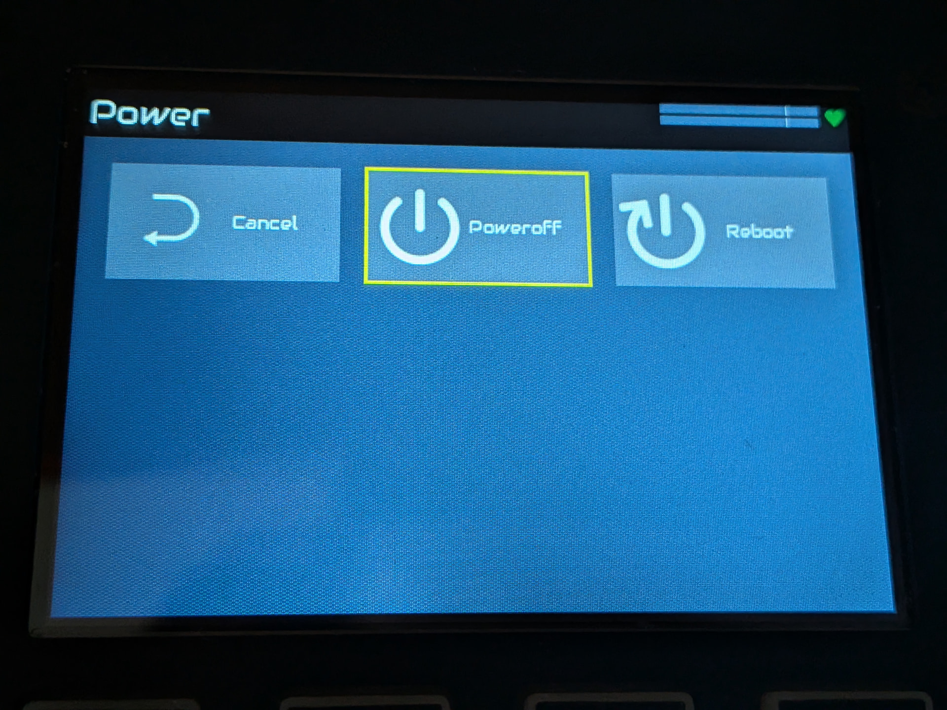

I couldn’t help noticing something else :sweat_smile:
Fast navigation > Power (Reboot) shows ‘Do you really want to power off?’ :cross_mark:
So either the icon title should be changed or it should call the reboot.
Admin > Reboot shows ‘Do you really want to reboot?’ :white_check_mark:
Short press to power off. Bold press to reboot. I realise the legend text might be confusing. Any suggestions for improvement?
I see it’s by design.
I feel it kind of breaks the easy learning curve of having this screen in the first place.
Options:
  • split Reboot and Shutdown into two buttons. Drawback: we fill up the whole screen already.
  • merge the shutdown/reboot screen into one where you can choose:
    shutdown, reboot, no options
    However this may break the logic of using Yes/No/Back buttons…
  • Or just remove reboot and shutdown as it really is already part of admin –> what do others think? And BTW the same can be said for audio levels. We need to take into account the frequency of these options vs overhead of reading the screen/putting more important stuff here later.
This is the idea I had. I have it working but there is a merge conflict I need to resolve so it might be tomorrow before I can roll that out. It is a neat solution. The reason for having the power option in the fast actions menu is because we want to encourage users to close down properly, with the benefits of saved last state, etc. I find it a bind to menu dive for this on a touch-only screen.
[Edit] This is now deployed. There is a single “Power” entry in admin menu and a single “Power” button on the fast launcher. These show a screen with 3 buttons:
  • Cancel
  • Power off
  • Reboot
Pressing any of these buttons triggers the corresponding action immediately. This is a neat workflow that many will be familiar with with desktop OS shutdown / reboot options.

Thanks @riban , working as expected.
I would align the spelling of powering off and Power off, e.g. change to Power off.
I changed the working to “Shutdown” and “Shutting down…”. I think this is okay because “Shutdown” is the correct verb but shuttingdown is not.
