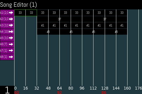

That is cool. I love the fact thatyou are up to pattern 45 .
I notice you have tempo markers which reminds me that these do not work. I can detect tempo markers but there isn’t a simple way to subsequently influence the master clock which is a different module without MIDI input and there isn’t currently a channel between the sequencer library and the clock. I shall ponder some more… I am fairly sure we won’t be able to influence an external MIDI clock, e.g. a drum machine driving the Zynthian.
Don’t be fooled by the numbers. I organize the patterns in generous steps of 4 or 8 so that I can later insert patterns and then e.g. with the bass parts from 41-48. So I don’t have to write on notes.
(…I assume that we will have 128 patterns per song later?)
Tempo marker? They came in there by chance. I was looking for a way to save the song tempo, which I still can’t. And with the gui-redraw it is a real patience to crank down from 120 bpm to 60.
I will try to enable some form of tempo control soon. It looked so good but has proven to be rather tricky.
There are currently an arbitrary 999 maximum patterns which are not tied to individual songs. So you can have 128 patterns per song if you have 7.8 songs .
Of course you might find that your songs are not so complex and individual to require 128 unique patterns each! And there is always the chance I might add the feature to load and save different files… The maximum patterns was chosen to be higher than I reckoned anyone could be bothered to scroll the selector, and hence higher than is practical to manage within a single session.
