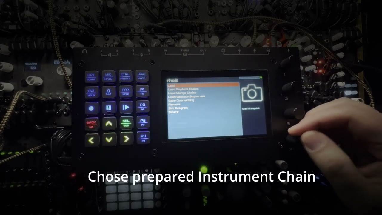

But there still is something I don’t understand:
– Load Replace ChainS (plural : ) replaces ALL chains.
– Load Merge Chains adds the chain to the existing ones. Close, but not there yet :slight_smile:
– Load loads Everything
I see why you’d make a Difference between loading everything (including Sequences) and loading almost everything (not including Sequences), but then, “Load replace chains” will overwrite everything else you had set up in the project. It may replace the selected chain and keep sequences for that chain, I suppose, but if there’s more than one chain in your project, this option does not make too much sense, because it’s overwriting all the other chains. Or am I, again, missing something fundamental? :slight_smile:
…or is it another bold press on the “load Replace Chains” Option?
I don’t understand. What do you want to do? I thought you wanted to load chains separately, so we explained this can be done with load-replace… but suddenly you want a different thing?
Please, clarify your use-case .
use case:
I am just missing a Save/Load Level between Processor Preset-Level and “complete State of the entire machine including all other chains too“-level. :slight_smile:
In your video, you selected “Load Replace Chains” which as you have already noted (plural) replaces all existing chains with the new snapshot. If you select “Load Merge Chains” then the existing state remains intact and the chains within the loading snapshot are added (merged) which sounds like what you are requesting. There is not a “Replace Chain” but you can do this in 2 actions by deleting the chain the merging chains.
As previously requested - explain what version of firmware you are running and what exactly you want to do… and RTFM.
[Edit] Please be aware that loading snapshots is a slow action. It is not intended for live use. It should ideally be done at the start of a session / performance. ZS3 is the in-performance mechanism for modifying the state quickly.
Yes. That merges it. The new chain gets added to the right in the mixer.
But I tried to replace that one chain.
I plan to prepare a handful of complete Instrument chains with their custom FX chains and everything, and then use the “LOAD REPLACE CHAIN(s)” to load an entire Instrument chain when I need it. I know, I could merge and then go back in, delete or mute the chain I wanted replaced, and use the new, merged one. This might look like a tiny inconvenience, but in a dark, hazy and chaotic club situation, where I need all of my brain’s bandwidth on the modular synth, every additional button press or menu dive is a new source of failure :slight_smile:
