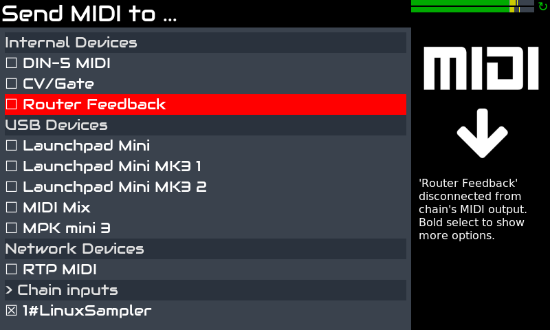

Yes, as i commented above, this is implemented in testing (vangelis) and also staging (oram) branches. Simply check the “Router Feedback” entry in the chain’s MIDI Out submenu.
This is useful if you really need the MIDI output to be re-processed by the MIDI router. Important to note that MIDI feedback is routed thru the “MIDI player” port.
If you only need to send MIDI notes to other chains, you could route directly to the MIDI chain’s instead of feeding back the MIDI router.
Enjoy!

Amazing! I will test it out as soon as I can. Thank you!
sending pd to the router really gives it that swiss army knife feeling
