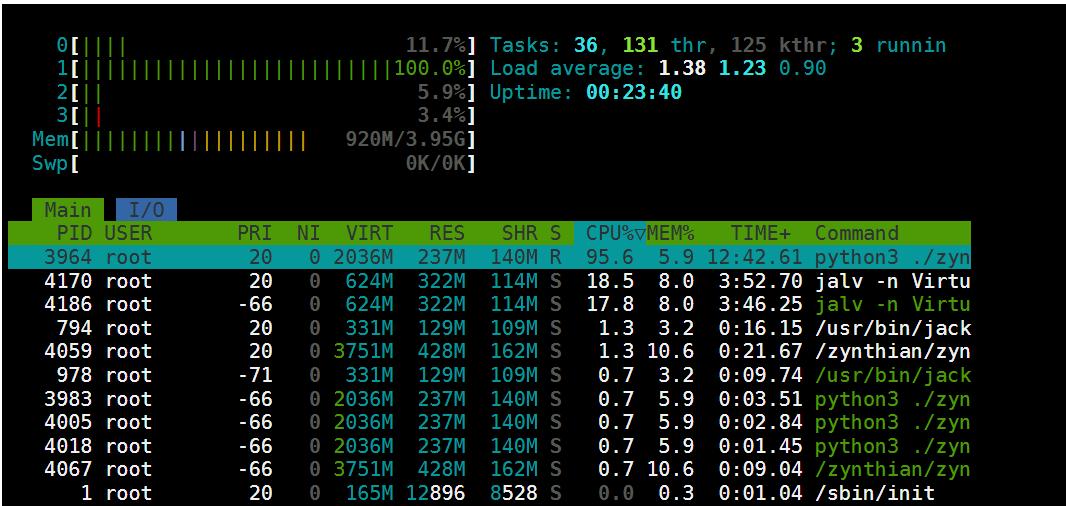

Htop after it happens… Probably one cpu is at 100%. That’s useful.

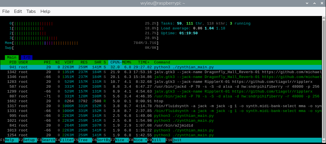

This one is from a zynthian not doing a lot. . .
htop
These sorts of things are low level and there are normally no log entries to dissect.

in this moment Zynthian is frozen:
*root@zynthian://zynthian# journalctl -fu zynthian *
