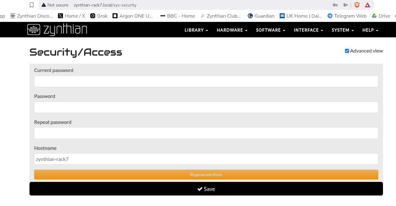

Perhaps we need a place in the UI (Web?) to rename our Zynthians to make this easier.

It’s in advance of system under security/access on webconf…
