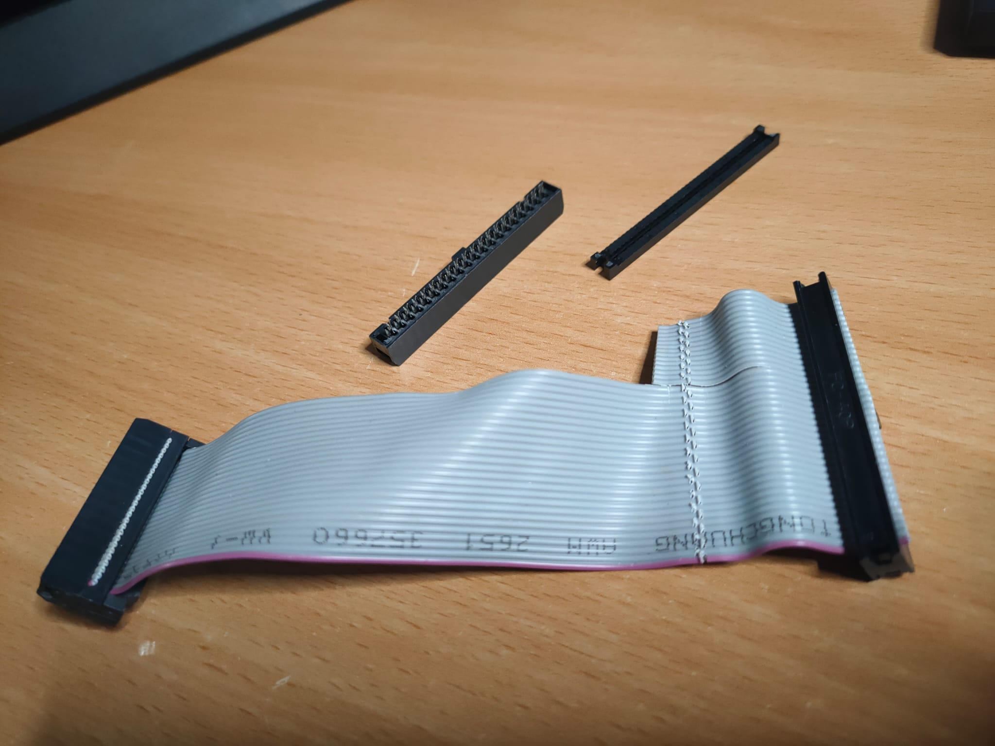

First of all, thanks everyone for the suggestions. I’m finally back home from work so i took again the old cable to check the situation, wich you can see in the photo. I decided i’ll try to fix it before building a new one.
