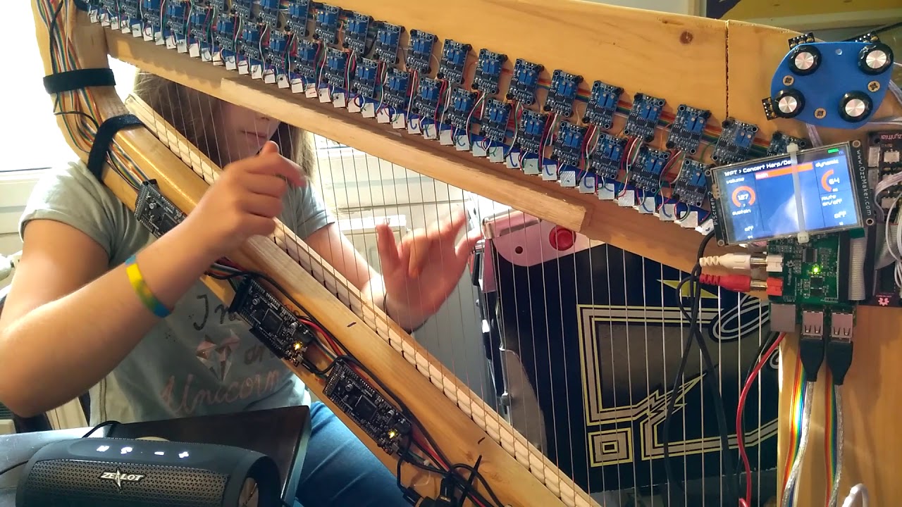

Hi !
It was a long time ago
I’ve made some minor improvements since (to decrease the (real) string noise), but, as my daughter prefers to play on a real one, I’m not as much in this project as I used to be.
That said, I otfen plug it to see if everything still works. I think I’m not done with it, just waiting for the right time to finish it (I have to build the pedals) !
Hi @Djihatch, your harp is totally crazy. It’s worth finishing this one.
